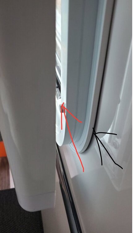

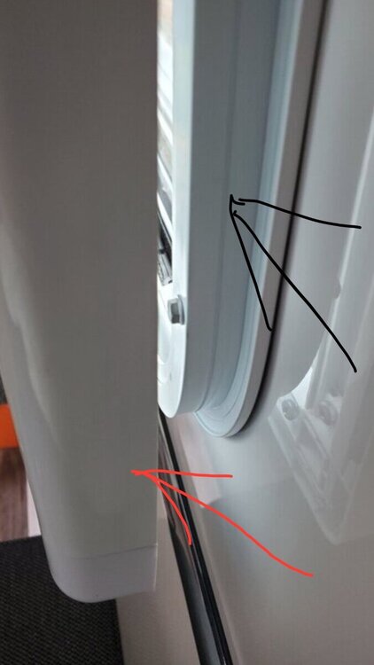

@John and Debbie Is it the window frame (black arrow) or window shade (red arrow) that’s loose?
**Sold😞**
It's the window frame, the red arrow in your picture.
The red arrow is not the window frame, it’s the window shade. Here is an Oliver video that shows how the window shade is removed/secured.

I see there’s a bit of a gap between the window frame and inside wall (black arrow), when you have the shade removed check to see if the screws that secure the window frame (red arrow) to the main window are not lose, but pay attention not to over tighten them, they strip easily. image.thumb.jpeg.afcd62ff8e3e209132037cac64262aa5.jpeg
All looked good.  I was able to snap the window shade back in after checking that the connection points were secure.  Thanks for the help.
