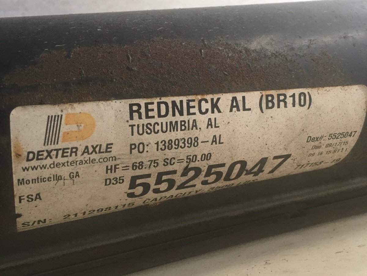

T-Oliver Posted June 22, 2025 Posted June 22, 2025 (edited) If it’s any assistance these D52 axles were installed on my 2017 OEII hull 254 Yes they are NevRLube axles in Edited June 22, 2025 by T-Oliver 1
jd1923 Posted June 22, 2025 Posted June 22, 2025 (edited) 8 hours ago, T-Oliver said: If it’s any assistance these D52 axles were installed on my 2017 OEII hull 254 Thank you very much. I see the marking 50.50 which is the length in inches. Your picture reminded me that I took a picture of our label 2 years ago when servicing the hubs and installing Timken Bearings. So, I don't have to get under and measure again. Our hull has the 50" axles, see the 50.00 in my picture. I still would love to see a label picture showing D52 and 50.00, somebody please?! Thanks again! Edited June 23, 2025 by jd1923 Had the # wrong. Does anybody have a picture of a D52 50.00 label? Chris & John in Prescott, AZ | 2016 EII #113 | '01 Ram 2500 Cummins!
