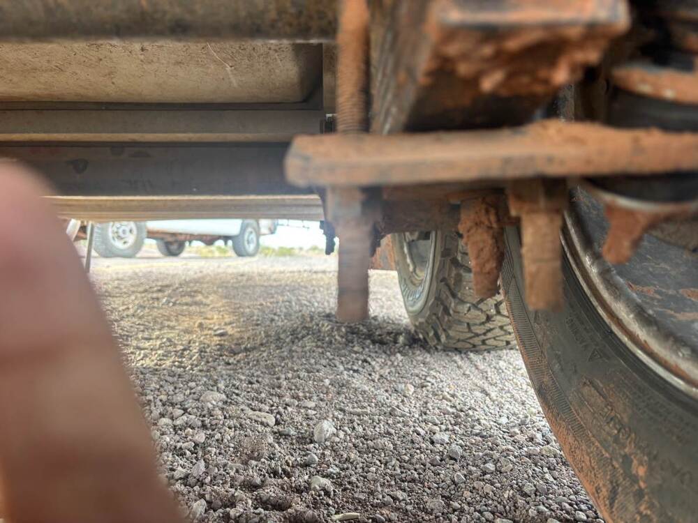

It started yesterday morning after a trip on a very rocky road south of Flagstaff that I swore I would never go on again.
The first sign of trouble was a tire on the back left rear that was punctured and its side wall, apparently by rocks.
I replaced the tire - but then the in late afternoon well on a dirt road in the mountains, I heard a rubbing sound then found that the left back rear tire was rubbing against the tire in front of it.
I removed the tire to find a broken leaf spring and shock. IMG_1732.thumb.jpeg.96231d0d1a2a6d62b4f011f1a20da245.jpegIMG_1734.thumb.jpeg.cc41ff60ec9373413f1be7a2cfb31c40.jpegthen I looked on the other side to find the leaf spring and shock broken there as well. The shock was actually rubbing against the tire.
it seems like I have three options.
(1) Try to get a tow truck in here and tow the trailer to a shop. If anyone knows of a good shop, that would be helpful if I do this.
(2) lash the axle to the frame and try to get the trailer to the paved Road maybe a mile away and get it towed from there and save some money.
(3) Try to fix it here myself. From looking at the Internet, it appears that these repairs are not too difficult - but I’ve never done that before.
One question I have is whether other things were damaged and therefore I couldn’t do it properly.  Don’t know how to tell that.

Wow, sorry to see this happen.  Other’s have had similar experiences so maybe they can advise.  Once you get this sorted out a trip up to Grand Junction, CO to get a set of ALCAN springs installed might be worth the trip.  Good luck, I hope this gets resolved quickly. Mike
Thanks for the tip. I was surprised at how thin those springs were!

I'm not familiar with trailer shops around Flagstaff, but unless you have backup parts the first thing is you need to source the correct replacement leaf spring. I would call every trailer shop around Flag to see if they have the correct leaf spring. I bought the following parts, 2 springs and a u-bolt kit so I could fully replace springs on one axle, left and right, on the road if this were to happen to us. Drive slowly and carefully if you only replace the broken spring on one side as the other will become the weak link.
Very sorry for your predicament!
I believe the part number SW4B is all you need to order.
I ordered these from SW Wheel which you can see online for reference:
SW4B-BR TruRyde® 4 Leaf 25 1/4" Double Eye Trailer Leaf Spring Bronze Bushings 1750 lbs
APUBR3BX Southwest Wheel® U-Bolt Kit for 5,200-7,000 lbs. 3" Trailer Axle - APUBR3BX
I have read on this forum that eTrailer will overnight these parts.
Perhaps SW Wheel would as well. Get on the phone asap!
As far as the shock, just remove it. They are unnecessary for travel.
You can install 4 new shocks when you install 4 new upgraded leaf springs.
Also, re-using U-bolts is not suggested. But I would if I was replacing just one leaf to get home or to a safe place to park the trailer.
Hope this helps! Best wishes, JD

Also, if you decide to do this yourself...
I have not done this work myself on a trailer but would get through it if I was there. Members here, like @ScubaRx and @MAX Burner and a few other have DIY this job and could help walk you through the steps.
Thanks! I called Oliver and while they gave me specifications
Spring capacity 1750 lbs, axle capacity 3500 lbs; bronze bushing 9/16th inner diameter; 11/16th outer diameter; length from center of spring eye to center of spring eye (unloaded): 25-1/8"; spring width - 1 3/4"; leaf thickness: 5/16th; number of leaves - 4
They could not provide a brand or part number  - so SW4B is a great help.
Amazon has some but will not deliver. I will check out trailer shops.

If you are a die-hard off roader 15% of all the OTT owners, then the ALCAN's are your best path with their over-sprung 5 leaf. But in your situation it will be a PITA to get them to make and ship you a set with all the hardware.
On the other hand, any mechanic shop can do this job.  Make your deal with them for the labor and you can call Dexter and get the much more nationwide available PR4 springs as have been discussed on several forum pages as a very suitable alternative for about 85% of OLLIE owners.  I would personally find out where the closest stocking dealer is to your location.  Drop the trailer at a local shop, and drive to the stocking dealer and pick them up.  That would save you the most time.
For my 2018 OTT with the OEM Gear I used the parts listed below.  Add to that four shocks.  Replace all four springs, with the parts listed.  They are an exact match size wise, but are 2400 pound rated vs your 1750 ones that broke.  Cost will be SIGNIFICANTLY less than ALCAN's.
In the mean time, dump your tanks, off load all heavy things you can and follow the steps in the attached "What If" document.  Just modify it for spring failure vs. two flats.

Here is a DIY for changing of the springs:
DIY - OE2 SPRING REPLACEMENT PROCESS and INFO Dexter OEM PB4B (1750#) with PB4 (2400#) Springs (1 APR 2024).docx
You would be packing really heavy to have all the needed tools for a camp site swap.  But you could get them at any Super Walmart.  Key is safety being under the trailer working on a soft ground surface while boondocking.  So some extra planning is suggested.... like a sheet of 3/4" plywood for the jack stands and jack to work off of.
Working on concrete, the first side took me a very long frustrating full day.  The other side was a breeze.  Like less than half the time.
Hope the above posts are insightful.

A rocky road is a reason to tear the sidewall of a tire. Leaf springs need to handle the weight of the trailer regardless of conditions. Hitting an uneven bridge seam or RR tracks on a 65 MPH highway is a lot more stress on springs and shocks than the bumpiest road traveling <20 MPH. No excuses for these lame Dexter leaf springs!
Thanks for the instructions. I actually carry all of that with me - I didn't envision a day long job though - darn!

I replaced two springs on the same axle at a campground after one broke and the other was failing. Took 4 hrs using the onboard rear “stabilizers” and a bottle jack. Found a pair of springs at a local rv shop. Once I made it home I replaced all four with Alcan 5-leafs and never looked back. 10,000+ trouble-free miles on the Alcans. It can be done if you have the tools.
PM me and I am happy to talk you thru the process.

Lew at Alcan will get you squared away with new springs and even a pair of 5200# never lube axles if you are so inclined.
I suggest the heavy duty shackles and wet bolts that Alcan sells if you decide to go this route.

This has nothing really to do with Oliver. 3500 lb axels and 6 year old trailer. The main contributing cause for these 4 leaf failures, are living near the coast, driving on chemically treated roads, resulting in rusting.
The OP was clear on his driving on a washboard road with deep chuck holes. This is a sure way to have 4-leaf spring failure.
Starting in 2022 Oliver went to the 5200 lb axels. There have been few if any failures on the trailers from 2022 to present.
John yes they switched to the 5200lb axels, however they stuck with the 3500 pound 4-Leaf spring packs that have always accompanied the 3500 pound axles.
Edit: ....and from THIS post by @Geronimo John, a tech from Dexter stated that the stock 1750lbs rated 4-leaf springs are under specification for a 6,000# RV trailer that is always loaded. On our 2023 the 4-leaf springs are already showing signs of flattening, so I agree with the Dexter tech that the stock 1750lbs 4-leaf OEM springs are under rated for our LE IIs, unless maybe for those weekend warriors that will just go to their local campground.
