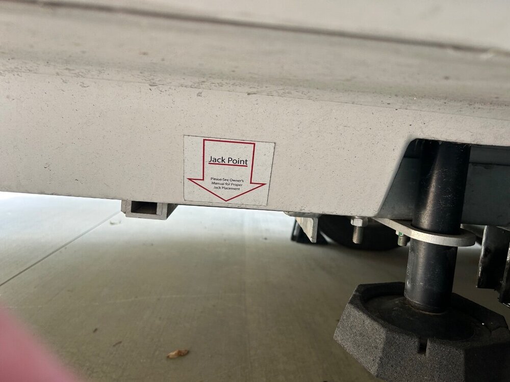

Patriot Posted June 24, 2025 Posted June 24, 2025 (edited) @Tony and Rhonda I cannot speak for early model Olivers, but our Hull #634 has labels for all jack points on the frame. I clearly remember being told by Oliver Service to use these jack points (pic) and NEVER the axle as a jack point as you risk possibly damaging the axle. So per Olivers advise, I never use the axle as a jack point or place jack stands supporting the axle. Some owners will use the levelers as a jack to change a tire. Again not recommended by Oliver likely and most wisely for liability reasons especially if the leveler should fail. But what could possibly go wrong? 🤷♂️ Rather than go down the 🐰rabbit hole, here is an old thread talking about all things jacking up your Oliver. You may find it interesting and entertaining. According to the link below earlier models had a shorter frame and as a result no jack point marker/decals. Stating the obvious here, it’s a good idea to always keep your tow vehicle coupled to the trailer when lifting it. Here is the jack that lives in my TV and for our Oliver. It has strong reviews and it happens to be on sale now. -https://www.amazon.com/Powerbuilt-620471-6000Lb-Unijack/dp/B00GJJZ5NI/ref=srj Edited June 24, 2025 by Patriot 1 3 2020 OLEII - Hull #634 aka- “XPLOR” TV 2021 F350 6.7 liter Diesel Lariat Ultimate Tremor aka - “Beast of Burden” Truma Aventa 13.5 AC, Alcan 5 leaf pack, Alcan HD shackles & HD wet bolts, 5200lb never lube axles.XPEL 10 mil PPF front both front corners, 30 lb LP tanks, Sea Biscuit Front Cargo Storage box. ⚡️⚡️11/2025- Lithium upgrade to XPLOR - (2) Epoch 300ah Lithium batteries, Victron 3000W MultiPlus-II, Victron GX Touch 70, Victron Cerbo GX, Victron Smart Solar MPPT, Victron Smart Shunt, Victron Orion XS 1400 DC-DC charger, RV Soft Start. Zamp 90W suit case solar panel for 420W of solar.⚡️⚡️ North Carolina

jd1923 Posted June 25, 2025 Posted June 25, 2025 I thought I was done, but... The older hulls did not have labels for jack points. Be VERY careful if jacking up you Oliver at these locations. If your jack arm is too wide or it slips you could so easily crack the fiberglass hull there. It is surely safer to use the stabilizer jacks. To have viable jack points, OTT could have made the steel sub-frame 18-24" longer so that there was steel at the jack points. Instead, the marked jack points are on the aluminum frame. When I purchased our Oliver, it had two broken welds, two cross-members disconnected, right behind the curbside wheel. Right where the jack point label is shown in the picture above. Chris & John in Prescott, AZ | 2016 EII #113 | '01 Ram 2500 Cummins!
