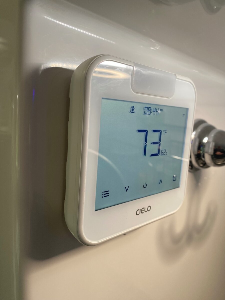

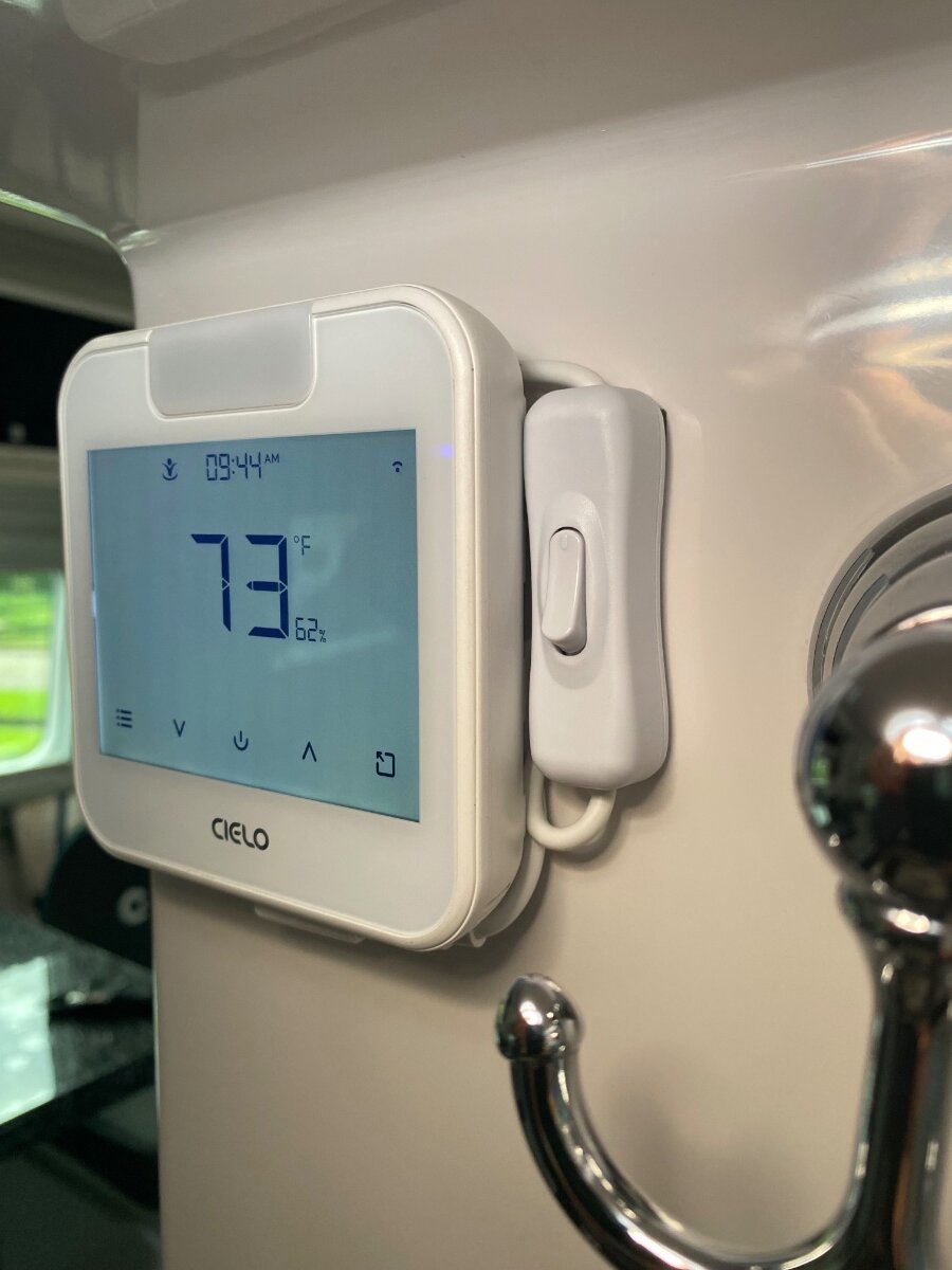

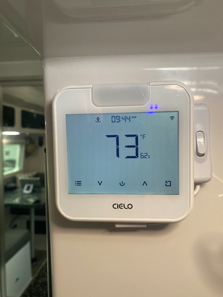

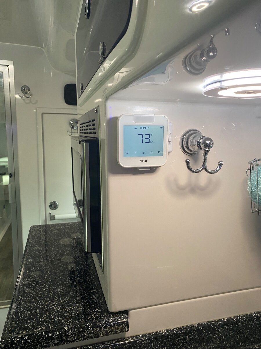

Treasure Coast Vault Posted July 4, 2025 Posted July 4, 2025 I went ahead and started a thread for this Smart Thermostat. I just installed it for my Pioneer Inverter and it works like a charm. Fan shuts down with the compressor. A wonderful little gadget. Thank you folks for showing us this. All I did was use the USB port in the Ollie for power and it was a "Breez" to get connected. Thanks for schooling us on the comfort modes too. 3

Ronbrink Posted July 5, 2025 Posted July 5, 2025 (edited) Good to know information on and my experiences with the Cielo Breez Max, buried in my Dreiha Atmos 4.4 Home Install thread, got some attention. Thanks @rich.dev for the mention! Edited July 5, 2025 by Ronbrink Ron and Brooxie | Clear Lake (Houston), Texas 2020 OLEll, Twin, 579: No installed solar, dual 30# propane tanks w/GasStop safety devices, Renogy 40A DC-DC charger, 460Ah LFP battery bank/Victron SmartShunt, auxiliary Cerbo-S GX/Victron 30A Blue Smart IP22 Charger combo, interior mounted Hughes Autoformer, twin independent sliding Lagun mount tables, extended dinette table and pantry landing, tongue-mounted hoist, Beech Lane refrigerator Ventilation/Evaporate Coil fans, metal valve stems with TST cap sensors and signal repeater, Waste Master sewer hose management system, Dreiha Atmos 4.4 A/C upgrade/Ceilo Breez Max thermostat, FlagpoleBuddy Starlink Mini suction mount kit. 2019 GMC Savana 2500 Cargo Work Van: Explorer Limited SE, Low-Top 7 Passenger van conversion, 6.0L V8 Vortec, 6-Speed Automatic, RWD; Air-Lift LoadLifter air suspension/WirelessAir compressor; Bilstein B6 4600 Series shocks; metal valve stems for TST tire pressure monitoring system; Buyers Products cargo containment boxes/DC Cargo securement system; rear bumper DC-DC Anderson power cable outlet; 100Ah 12V portable power station/Dometic CFX 75L Dual Zone cooler; front 2” receiver hitch/QuikrStuff Mach2 double bike rack; Mechman 320A high output alternator; Starlink Mini/Veritas Vans magnetic mount.

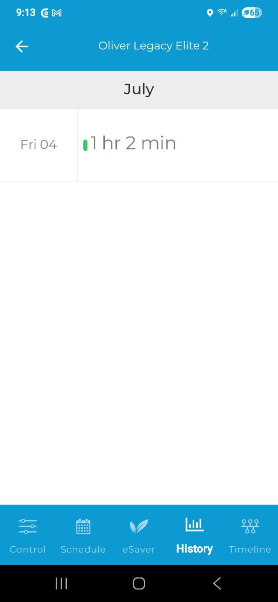

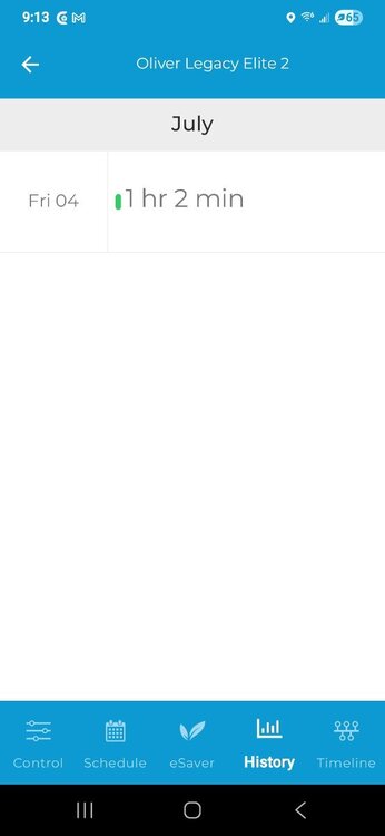

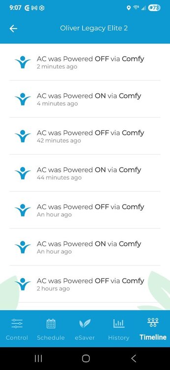

Treasure Coast Vault Posted July 5, 2025 Author Posted July 5, 2025 Thanks for posting this Thermostat @Ronbrink. I would have never found it without your original thread. Here is the way the Pioneer cycles in the Ollie 2. It is in an A/C space kept at 80 degrees with the Pioneer set to 76 for testing. 1
Ronbrink Posted July 5, 2025 Posted July 5, 2025 (edited) 1 hour ago, Treasure Coast Vault said: Here is the way the Pioneer cycles in the Ollie 2. It is my understanding that these inverter a/c units are designed for always-on cooling, wherein the fan and compressor run continuously at variable speeds for better dehumidification and energy efficiency. It will be interesting to see any differences noted in normal operation of your unit compared to that when using the Cielo in Comfy Mode. Edited July 5, 2025 by Ronbrink 1 Ron and Brooxie | Clear Lake (Houston), Texas 2020 OLEll, Twin, 579: No installed solar, dual 30# propane tanks w/GasStop safety devices, Renogy 40A DC-DC charger, 460Ah LFP battery bank/Victron SmartShunt, auxiliary Cerbo-S GX/Victron 30A Blue Smart IP22 Charger combo, interior mounted Hughes Autoformer, twin independent sliding Lagun mount tables, extended dinette table and pantry landing, tongue-mounted hoist, Beech Lane refrigerator Ventilation/Evaporate Coil fans, metal valve stems with TST cap sensors and signal repeater, Waste Master sewer hose management system, Dreiha Atmos 4.4 A/C upgrade/Ceilo Breez Max thermostat, FlagpoleBuddy Starlink Mini suction mount kit. 2019 GMC Savana 2500 Cargo Work Van: Explorer Limited SE, Low-Top 7 Passenger van conversion, 6.0L V8 Vortec, 6-Speed Automatic, RWD; Air-Lift LoadLifter air suspension/WirelessAir compressor; Bilstein B6 4600 Series shocks; metal valve stems for TST tire pressure monitoring system; Buyers Products cargo containment boxes/DC Cargo securement system; rear bumper DC-DC Anderson power cable outlet; 100Ah 12V portable power station/Dometic CFX 75L Dual Zone cooler; front 2” receiver hitch/QuikrStuff Mach2 double bike rack; Mechman 320A high output alternator; Starlink Mini/Veritas Vans magnetic mount.
