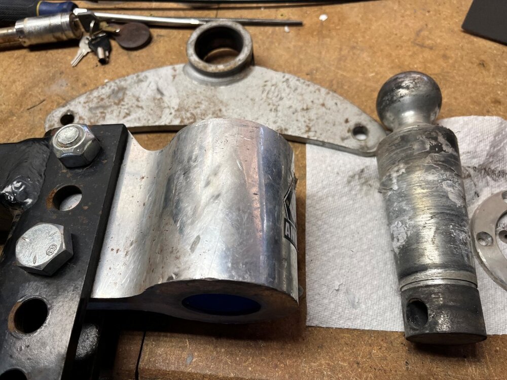

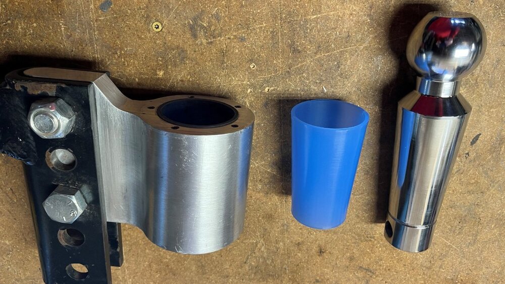

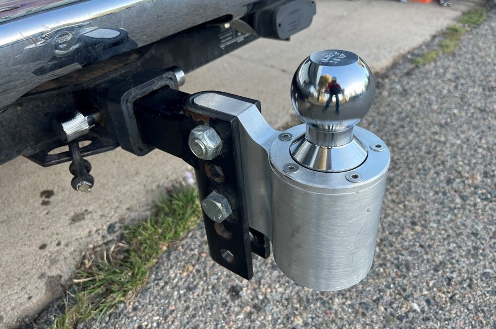

I didn't watch the video but what I did was turn the hitch upside mounted to the rear of my truck. Then I hit it firmly with a 5-LB hammer and it dropped down to the ground on the second strike.
I was replacing the ball too, going from a 2" to a 2 5/16" ball so I did not care if I dinged the ball. If I was to reuse it, I would have padded the shaft before hitting it and placed something below to catch it nicely. Pictures show work in process...
