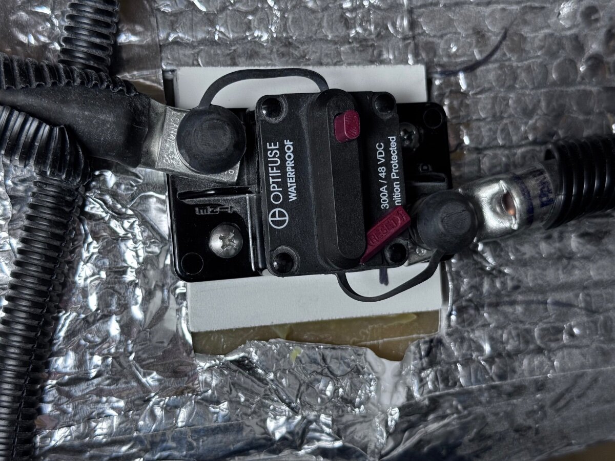

Mossemi- Sorry let me try to clarify, The Optofuse was between the 3 lithionics 130ah batteries and the 3000W Xantrex inverter/charger. (OEM from Oliver) My real question is does anyone use MRBF fuses, if yes what amp fuse are they using? Are they using one fuse or one on each positive terminal? Just wanted to see how others are handling the issue with the Optifuse breaker. I understand others are also having problems. image.thumb.jpeg.d7c3bb646eaf87d75af81939c1815537.jpeg

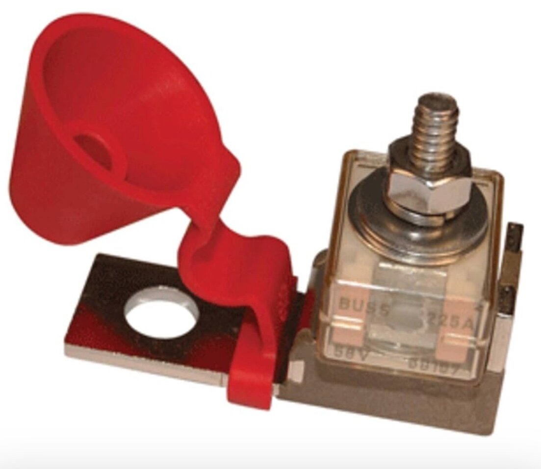

JD1923, I got ahold of Lithionics and they say MRBF Fuses are ok. They say I can do a single 300a fuse. This fuse attaches to the battery terminal. So protects right from the source.

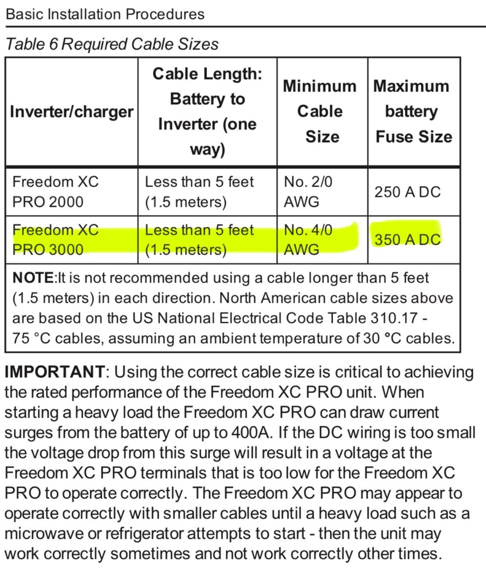

image.thumb.jpeg.762361daf3daa28a6f6e741c039a4349.jpegI also found out Xantrex recommends a 350a fuse max. image.thumb.jpeg.b14e7a8e99fa961280946740b49b6d62.jpeg
So the inline 400a I put in for testing will be down graded to 350a if not removed.

I use MRBF fuses for a positive bus I installed and also on my truck battery connecting our DC-to-DC charger. They are simple and inexpensive. And yes go with 350A given your Xantrex manual lists this spec.

The inverter is the largest load in an RV. Xantrex specs 350A as shown above. Victron specs 400A for the Multiplus II 3KVA inverter-charger. Best to go with manufacturer’s specs. The 400A is likely OK for the Xantrex too, or buy a 350A fuse and keep the 400A as a backup.

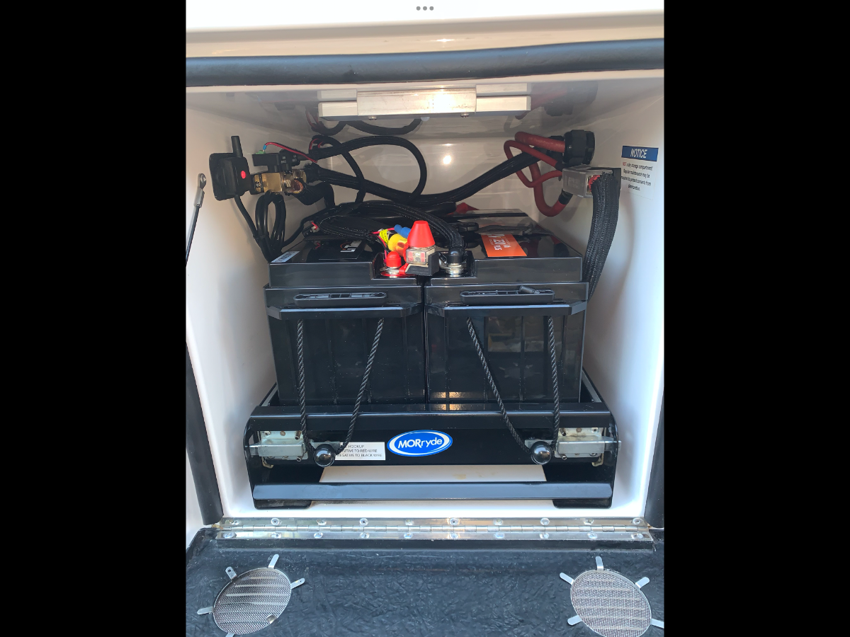

We did replace the 400 amp anl fuse with a 350 amp. Also installed a Blue Sea disconnect. I’m using a 350 MRBF terminal fuse block at the battery (it’s on the back terminal in the photo). Some day I may add them to each battery. For those who have been tracking my initial issue with the 300 amp Optifuse that kept tripping. It turned out I had a bad crimp on that cable connection. But I prefer the upgraded protection. 🙂
IMG_9806.thumb.jpeg.4af96d47120d10e936bc55118a49130a.jpegIMG_9805.thumb.jpeg.991f96d18959cfd9ccb3880c7eb8349d.jpeg
