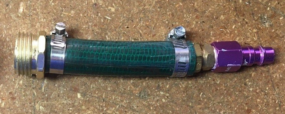

If all fails, I suggest blowing compressed air though it! 😎

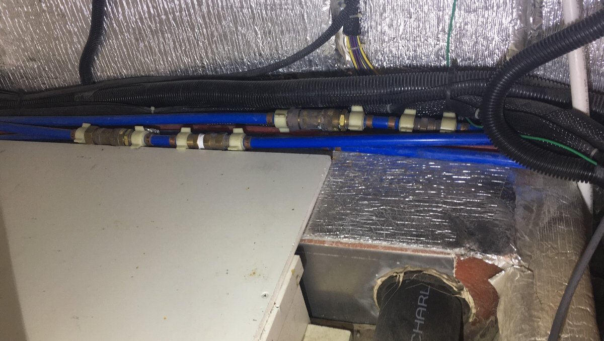

The City Water plumbing in our Oliver consistently has lower pressure/volume than using the water pump and Fresh Tank (though we do have an upgraded variable-speed water pump). In a way it's neat that when we do not need much water, City Water gives us just that (water savings) and when we want better pressure we turn the water pump on at the same time. This works to supply extra water pressure and volume!
I have it on my long list to remove the water restrictors in both lines and remove and clean and/or replace the backflow preventers (check-valves). Not sure how your 2019 is plumbed, but you can start by looking here to see what you have and decide what to do. Look closely to see we have BOTH check-valves AND water restrictors on BOTH City and Fresh water lines.
