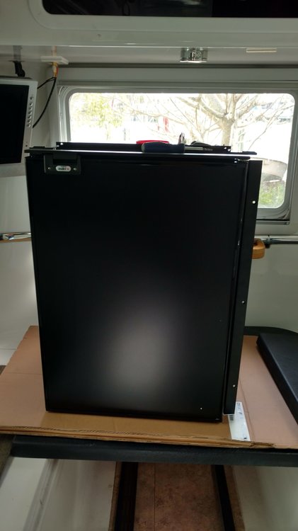

It arrived a few days ago. Plugged into 110 in the garage, it's super quiet, just a whisper of fan noise. (Built in fan behind the compressor). On high, it registered 36 on my electronic thermometer in the fridge. obviously, I will turn it down....
We have some adjustments to make, as the new fridge is much smaller outside than the old, but a little bit better interior capacity.

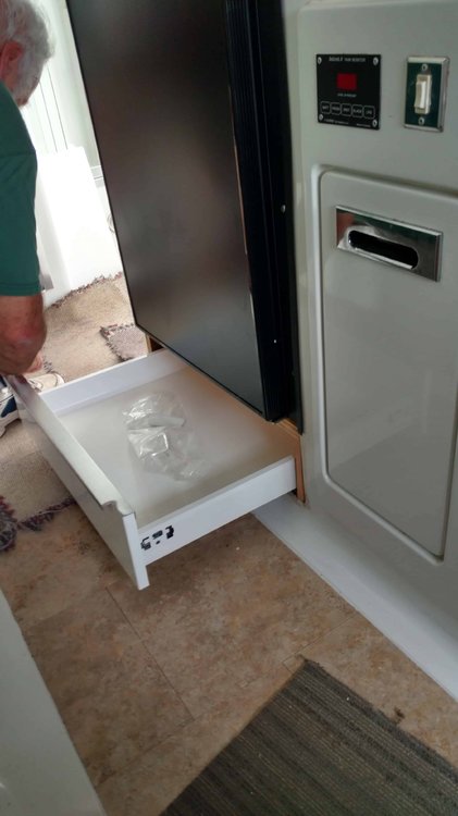

Working on the drawer beneath the raised fridge. Really happy if that works out.

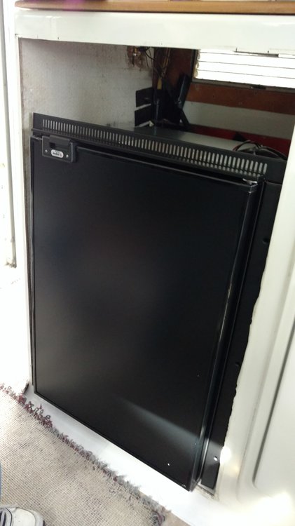

In the photo above, the new fridge is just sitting in the old cavity.
Looks tiny, huh? I thought so, too, though a slightly larger capacity than the old Dometic.
No more gas! This should run quietly and free, on our pv panels.

We went to Ikea on Sunday, and bought a drawer kit, to go with an old leftover drawer front for beneath the fridge. Also bought a drawer face for the old microwave cavity. I think the gloss white will look great with the Oliver white interior. We have 90 days to return, if not....

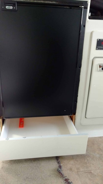

Dry fit looks good, though. I got my drawer. And a fridge off the floor... At least by ~6 inches or so.

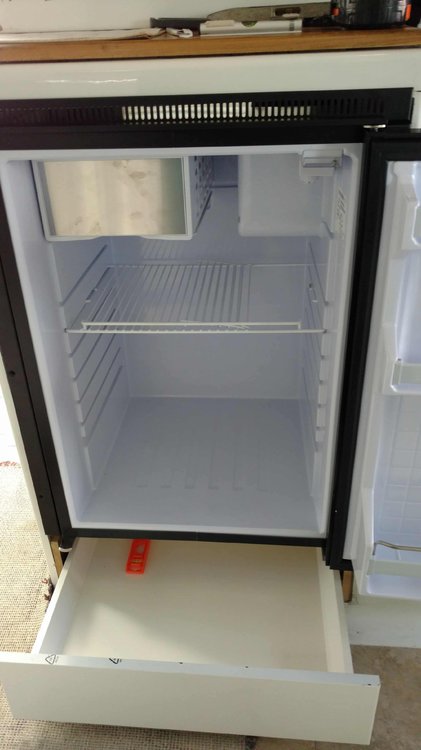

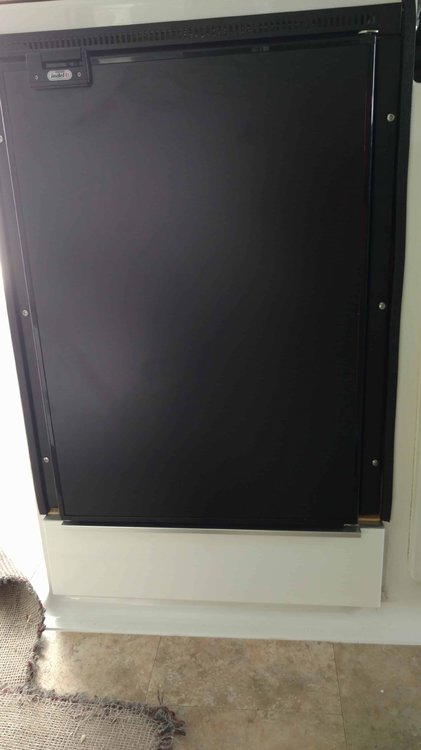

So, it's been a week, with other more pressing projects, and houseguests, too, but Paul finished the install of my new tf130. I'm so happy.
We plugged it in at 2:26 pm today, with batteries on 100 percent. Set the fridge to coldest setting, and closed the door.
Checked it every half hour on the monitor for power consumption. Running on solar only, in the shade. Went to dinner at five. Averaging 3.5 to 4.1 amps consumption.
At 8, I opened the fridge and checked the temp with my kitchen digital thermometer. 36 degrees on center shelf. Battery is at 12.4 volts, 93 per cent. Sundown was awhile ago, and in the shade, we weren't gaining more than .7 amps at best, from 2 to 4 pm.
.3 gain against draw when we left.
I'm so very happy with the performance so far. It was in the high 70 s today. Supposed to be 80, but I don't think we got there.
Planning to run and use the fridge on solar only in the shaded side yard for awhile, to see what we can expect when camping.
I'm also very happy to have the fridge off the floor by another seven inches, and a big drawer, six high, underneath.
We did use some recycled styrofoam panels as extra insulation on the sides.
The fridge is so quiet, I have to put my ear next to it to hear the low humidity of the fan.

Looking good! I really like the drawer. Please keep us posted on its performance - I'm curious if it works any better/worse than the isotherm over time. Mine seems to draw about the same amps when on manual, as you'd expect.
