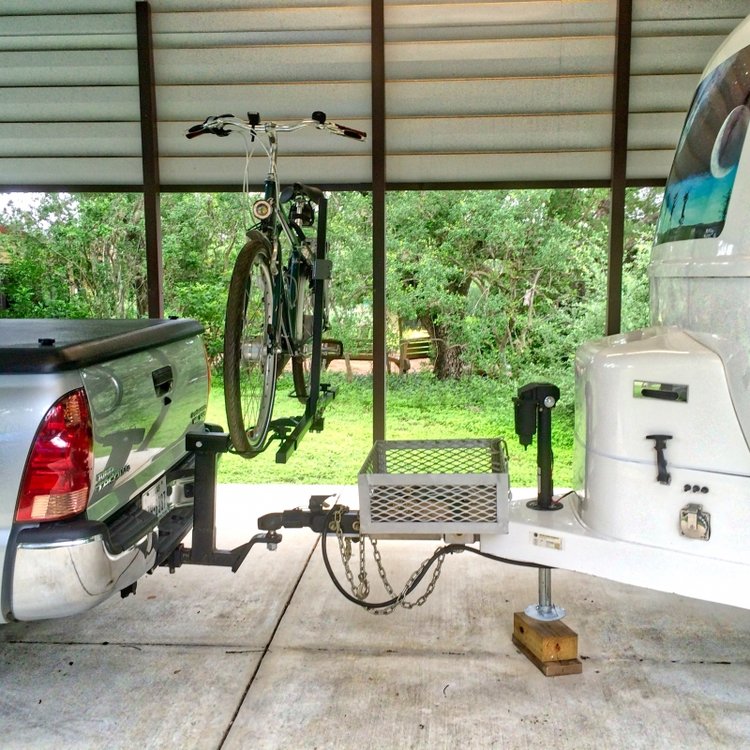

The Wonder Egg's rear bumper is too short to accommodate the new rear hitch option.  After almost having a front receiver hitch mounted on my truck, I went to a specialty hitch shop and found a 6000 lb tow rated, long tow bar with the correct rise for the main ball which can accommodate a 600 lb tongue weight.  We took some measurements and they firmly welded a hefty new receiver with a 17 inch rise for the bike rack.  My rack is a Swagman XC2 Platform.  I think this is going to work better than putting the bike in front of the truck where it would be the first item to hit the air, resulting in a huge parasitic drag issue.
Pete.  That hitch looks good but would  not work for me because I access the bed of my pick up truck frequently during our camping trips. I did have a rear hitch fabricated at a local shop out of steel and it is working out well although it is so high I have a hard time lifting our bikes up to it so I'm putting a platform on that hitch to carry my extra black water tank now.

Pete, your generator basket looks smaller than the standard factory version. Is it? The reason I make that comment is because you're not using the tongue extension which I have to with my larger generator basket. I would like to be able to eliminate that tongue extension because it adds some flex to the trailer we're going over bumpy roads. Can you comment as to the actual dimensions on your generator basket?
Current 2007 Airstream Classic Limited 31
2015 Oliver Legacy Elite II (Sold)
2016 Ram 2500 HD 6.7i Cummins turbo diesel
Trumpetguy, The Wonder Egg sports the very first generator basket Oliver ever made.  During the build, I was talking with Mountainborn, who was having a local welder in Arkansas make him up a monster basket with a solid cover so he could hide and secure his Yamaha 3000 generator.  (You know those mountainmen, they'll try anything). He said it kinda looked like a mailbox and I told him it looked more like a whole Post Office!   I thought that would be a great place for my 46lb Honda 2000, so I gave the Oliver folks some measurements and they fashioned my basket out of aluminum.  It's 19x23" rectangular and 8" high.  Now, however, I usually carry the generator in my truck bed and use the basket for my chocks & blocks or firewood.  The tongue actually is extended to the middle setting.
Because of the little bit of wiggle you mention on the earlier Ollies, I believe they are improving the newest frames coming off the line with a thicker, single piece extruded tongue, set at a nominal length wich can accomodate the newly designed, larger shiney aluminum basket with a cable pass-through cutout for a generator attachment.  They may be placing a recommended weight limit on it so's the mountaineers out there don't try to place a 20 ton nuclear generator on it.  hehehe
About my fabricated bike hitch . . . Because I have a short Tacoma and not a tall full sized truck, I'm able to lift the truck bed cover and reach inside for items. That would be difficult with a big truck.
Pete, That is a nifty bike rack but can you actually make a tight reverse turn without contract? It would be a shame to prang up both parts. The slightest grade (the trailer angled up) might make it impossible avoid damage, even with minimal stuff in the basket.....
Has anyone figured out a way to fabricate a vertical bike rack mounted on top of the trailer A frame, where your cargo basket is now? That might be a good alternative for a couple of bikes and it would allow full access to to the truck bed..

John, Good point of consideration.  There are actually several vertical inches of difference between the basket and anything on the arc of turn which might get close to the basket.  Now, if I was simultaneously making a very radical vertical angular change between the truck and trailer while in a very tight turn I may have an issue, but in all my years of travel, so far, anytime I've approached my left/right  turn limits I am on rather flat ground.  I should be very OK in 98% of my turns and cautious in the other 2%.
