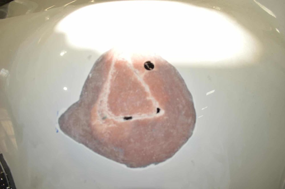

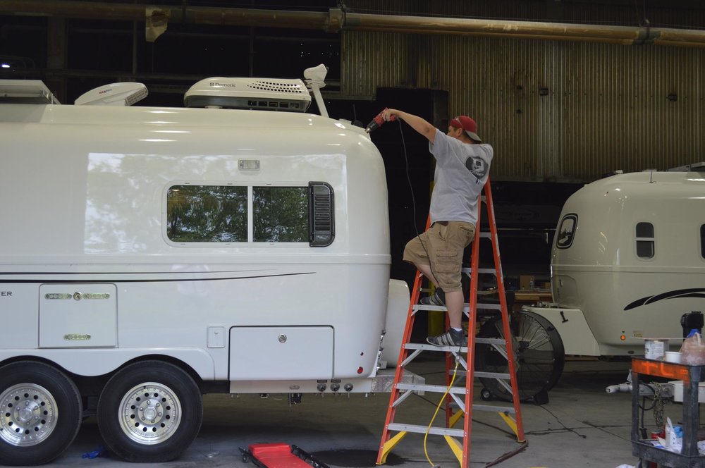

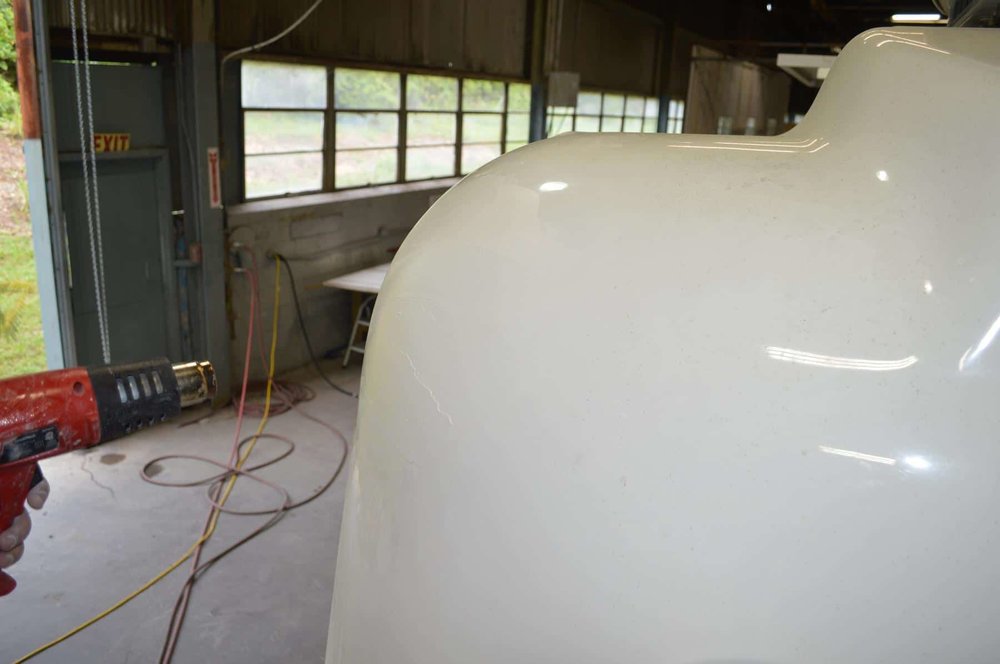

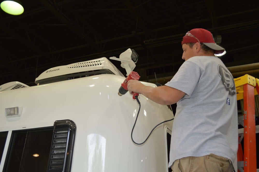

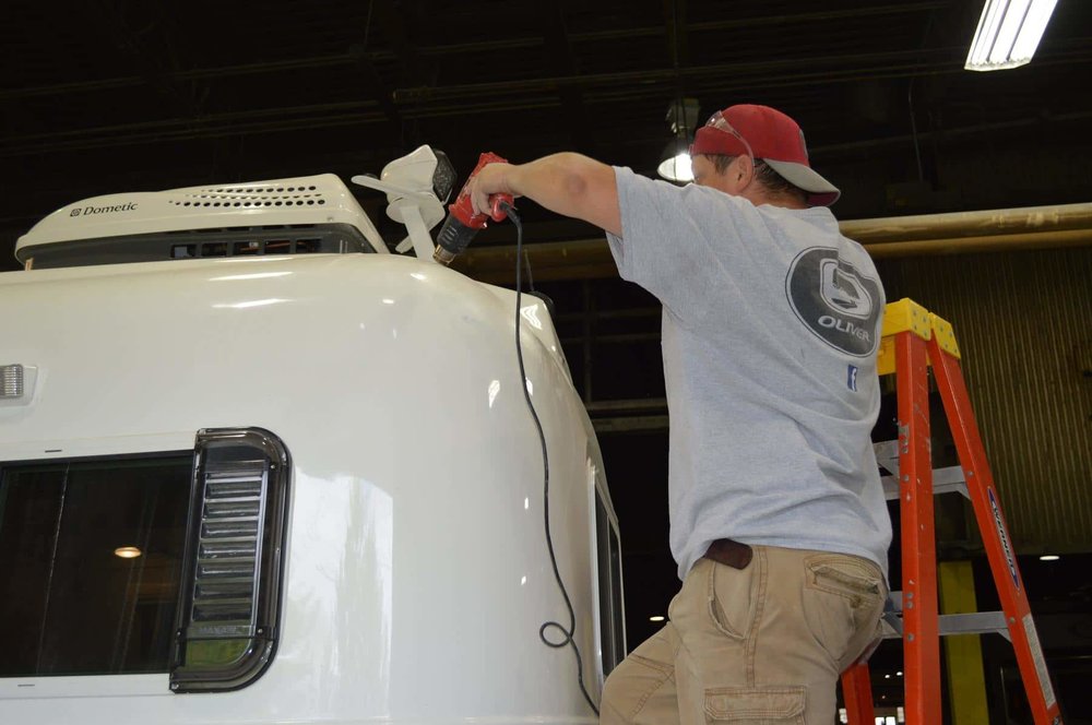

Moderator+ ScubaRx Posted July 7, 2016 Moderator+ Share Posted July 7, 2016 We’ve all had those “Awwww Shoot” moments where you wish you could have a do-over of the past few minutes. In July of last year I had taken the Outlaw Oliver back to the factory for an upgrade to the body where the rear jacks exit. This modification is now built into the mold and is standard on all current production models. While there I accidentally allowed the upper left rear corner of the trailer to come in contact with an “immovable” object. The first three pics show the results of that encounter. [attachment file=DSC_0918.JPG] [attachment file=DSC_0919.JPG] [attachment file=DSC_0921.JPG] The next day at the factory Phil Andrews started work on the hole. First, gel coat was ground away and the deformed piece was pushed back into position. Then the grinding, filling and polishing began. Now, you can't tell the hole was ever there. I cringe to think what a repair like this would cost if it had been an Airstream. I love fiberglass. 5 Steve, Tali and the dogs: Reacher and Rocky plus our beloved Storm, Maggie and Lucy (all waiting at the Rainbow Bridge) 2008 Legacy Elite I - Outlaw Oliver, Hull #026 | 2014 Legacy Elite II - Outlaw Oliver, Hull #050 | 2022 Silverado High Country 3500HD SRW Diesel 4x4 Link to comment Share on other sites More sharing options...
