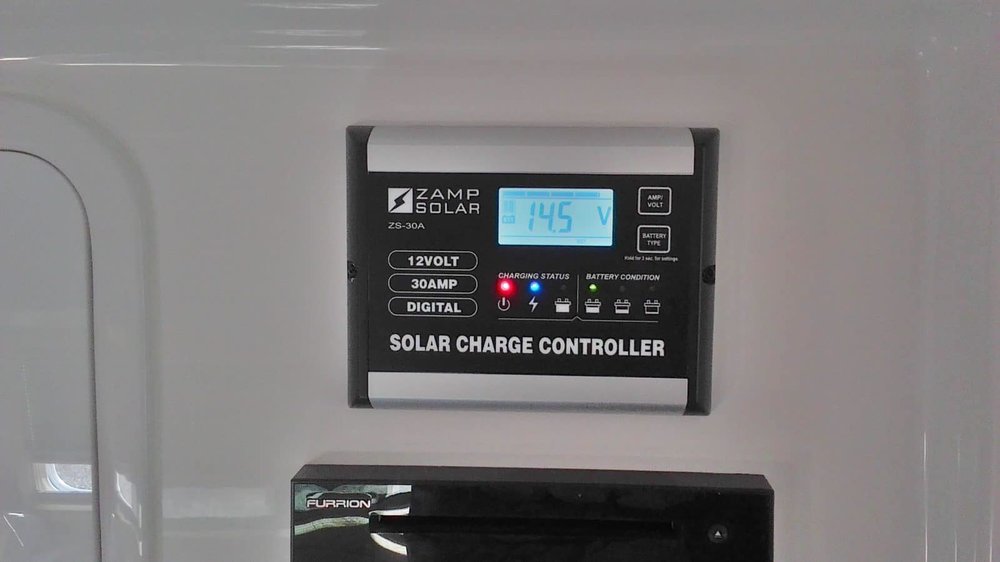

There's not much to say about this controller other then it's designed for beginners. It shows you the screens and that's it. There's no simple way that I know of yet, to make changes. So the 2 volt gauges in our trailer are 2 tenths different at times.
Edit - actually there's more... The controller is supposed to switch over to a regulate mode after reaching 13.6volts and ours didn't. It just kept charging at full according to the lights on the pannel until it hit 14.7volts that afternoon... I'm really not impressed with this beginners model of controller that doesn't even give you an off switch. I've got to pull the bed apart to turn it off. Really it's not a controller because it's just telling you what it's doing. As far as I know, you have no control at all... Look at the pic and see the different battery levels, the first 3 lights on the left should have lit up together at 13.6vdc and that shows that it's working properly at full charge. On our gauge here, ours has never shown fully charged yet, it stops at the next one over to the right, the 3/4 charge light. And that's where it stayed when it was showing 14.7vdc, which according to their pamphlet, means it was still on full power charging, way after the capacity was met.  The good news is that the containment meter still showed 13.7... Or is that good news when the 2 gauges are now showing 1 full volt of a difference between them? I'll watch it some more today and see if we need to take it back and get it fixed or maybe they have changed their idiot lights from their own written parameters.

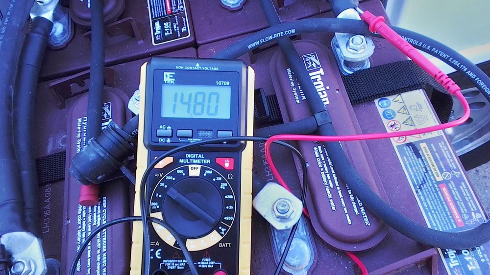

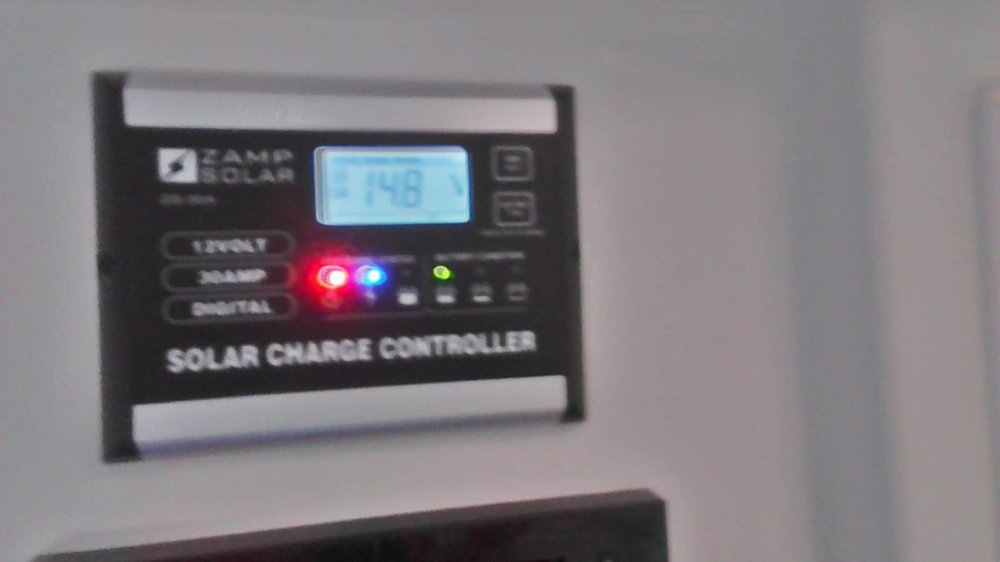

Here's where it is right now,it should be on "Float Charge" , but as you can see, it's still charging because the little blue lightning bolt is still on. Now we're at 14.5vdc on the Zamp and 14.3 on the containment, so I will be heading outside in a few minutes with the meter.

Looks like the Zamp controller wins as it's showing 14.8vdc along with the meter and the containment is only showing 14.6vdc. I called Jason at Oliver and he's looking into it right now.
We're in the desert today and the Zamp just flashed 14.9,so we will see where it stops. Right now it's 8:50am. Wasn't I supposed to be retired today, hahaha, the life of an RV'er... Lol.

Reed,

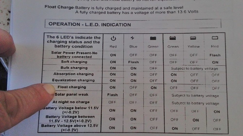

Sorry, more thoughts based on a review of your photo showing the LED indicator light chart.  Based on the chart, it looks like your system may be in the absorption phase.  In my system, it would progress to equilization at 15.1V unless turn off at either the controller settings of via the parameters.  Where you do not have AGM, it is possible your system is set to progress into the equalization phase.  I should think that is OK.
One thing I discovered with my system was the value in locating a very knowledgeable technician at Blue Sky.  Sometimes multiple sources of knowledge can be helpful in understanding systems that are new to you.  Just a thought.

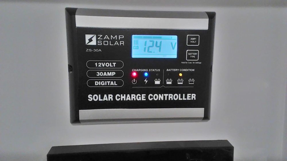

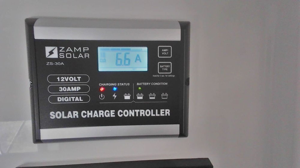

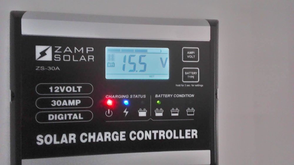

It's 1pm now, it's still charging at 15.5vdc/11.2a/31.8ah and it's still bouncing from 3 to 4 bars on the charge meter on top. 14.8 is max so, I'll await for Jason's call back and then talk to Zamp after Jason turns it back over to me. I am on shore power right now, so I will unplug later and get another full set of readings.
Happy Camping,
null

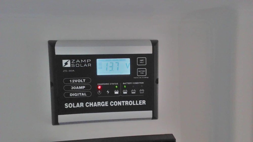

2:30pm it just kicked off. It was at 15.5 and now shows the battery back at 13.7/ 46.1ah. So it does kick off eventually. Still 14.88 should be the max so we will see what they say.
You can see that the blue light above the lightning bolt is off now.
Happy Camping,
null

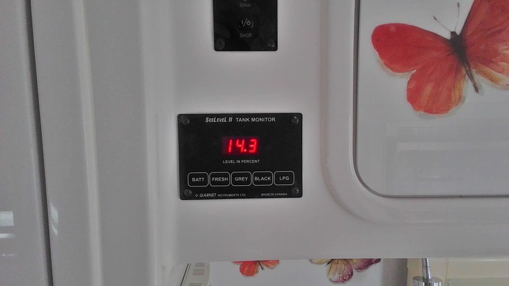

So if the Zamp controller only shows the charge voltage, does the SeaLevel II possibly show the battery voltage? Your meter on the battery terminals would still reflect the incoming charge from the panels as it would be higher.
Randy
One Life Live It Enjoyably
2017 F350 6.7L SRW CC LB
2015 Oliver Elite II Hull #69
Nope, the SeaLevel II shows basically the same. Just 2/10ths lower,so when the Zamp shows 13.6, the SeaLevel shows 13.4 which makes me think that it is less accurate being that it was 2/10 off on almost every take. So we don't have any way of seeing the actual voltages unless the batteries are isolated.

Reed,
Let me throw out a few comments/ideas to chew on.
1.       Learning how to operate and interpret data from new solar equipment can be daunting at first.  Feel free to lean-on our Forum membership for help.  Steve (ScubaRX) was the one who helped me.
2.       If you could post a link to your on-line technical manual, additional pairs of eyes can analyze the information.  Matt, our webmaster, guided me with providing the Dropbox link.
3.       I suspect your goal will be to arrive at locating two valuable pieces of data.  A.  The amount of charge in amps currently on your bank of batteries.  B.  The number of amps from full.  I have access to that data and they are the most valuable.
4.       Although I have a reading of volts from my controller to my batteries on the SeaLevel II monitor as well, that data is of no use to me.
5.       It does seem as though your system is operating as designed.  I would not be too concerned regarding the readings from your array to your controller.  The technician is correct that you could see a reading of 18 plus volts coming from your array on a sunny day.  I agree with the technician’s comment that the reading of volts from your array is not a meaningful piece of data in your daily operation of your system.
6.       It is possible that your controller uses the LED lights within the “Battery Condition” display to communicate the battery amps.  I would dig into the manual to determine if a more precise numerical reading is possible.  I should think it is!
