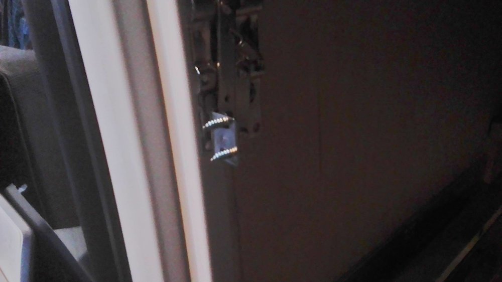

Here's a picture of the screws used to fix the drawers. I used the 1" grabber on the left, in the center is the screw that Oliver sent as a replacement, and on the right is the original that pulled out. The 1" grabber really goes in nice and tight.
Then for the sponge drawer I bought #12 x 5/8 sheet metal screws and that's as large as the hinge would take.
Then here's a pic of the Blum---ing slide
Then I had to reset all of the magnet bars so that the magnets would lock on to them. I ended up having to shim them all out about 1/8" to 3/16" and then loosen the magnet half a turn to get them to hold the drawers closed.
The drawers actually click into place now like they are suppose to from the factory and they hold strong. But... I have to say that we will be blocking them in place from now on with the cushions from the couch coupled with some pillows from the bed to make sure because the reality is, we haven't even been seriously off road yet and all this damage happened on normal paved streets. The original mirror door was weak, really weak when compared to the new one that we put in the other night and that was a quick and easy fix. But why the one door was so weak and flexible from the factory when compared to the new one is anybodys guess. It's been 3 months and we already have over 7000 miles on the new trailer. It's been quite a ride :)

Another set bites the dust... The replacement screws that Oliver sent were still too short, in my opinion, so I used 1" Grabbers. Then to lock the drawers back onto the slides, use a wash cloth or towel, pull the drawer and the slide out, then with the towel over your fingers, slip your fingers into the groove at the front of the slide and then pull the slide out into the locking mechanism that's screwed to the drawers, while holding the drawer in place or pushing it back to lock in the slidebar. You will feel and hear them lock into place. If you try it with just your fingers, it's slices up your finger tips just enough to feel some pain that takes a week to heal, but just holding a towel over them in the slide works great and totally protects your fingers from the sharp edges on the slide :)
