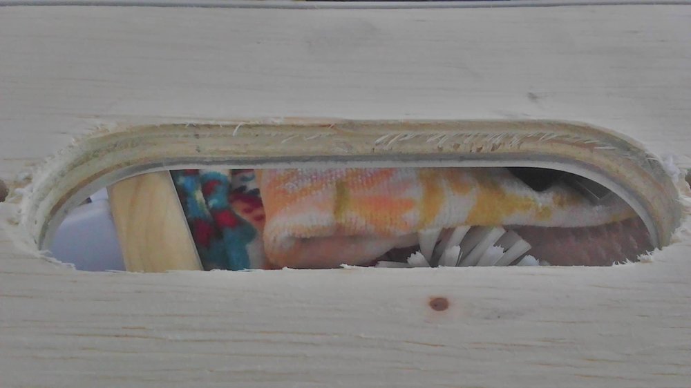

Are you sure one of you doesn't sleepwalk with a sledgehammer?
Don't know why or when Oliver switched over to the drawer mechanisms you have, but it looks like they need to rethink the change. The ones we have are rock-solid, screws are in the sides of the drawers, and do not come open underway. I don't have anything to measure the force required to open our drawers, but it's at least 10lbs and they never come open on the road. (Ours has a short drawer under the sink rather than the one that pulls down like yours.) With the location being so low on the door for those short screws means a lot of leverage is being put on them. The manufacturer should have provided longer screws. Looks like Oliver (and customers) are learning the hard way that Oliver will need to use different screws..... and probably fill the screw holes with 3m 5200 when putting the longer screws in.

Are you sure one of you doesn’t sleepwalk with a sledgehammer?
Karen does turn into the Hulk when confronted :) I think it's from the Fukushima water that we all love to drink here on the west coast. It's gotta be good if it's made in Japan, right? :)
Actually Jason sent us an email today warning us about the sponge drawer.... Just a few minutes to late... Apparently the 3 new 2017's that went out with ours, are all having the same problems and Oliver as you know, will make everything right. Unfortunately, I think it is mostly being caused by using pine as the cabinet backing. Are the 2016 and before cabinets made from pine or a hardwood?
We might end up with Cocobolo wood or abalone faces if I get inclined, it would be a simply beautiful fix :)

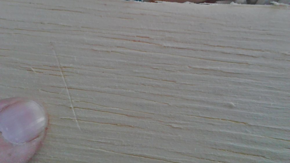

Is it not a veneered plywood? It doesn't look like the back of that door has been sealed either. I'd think it would have a coat of poly like the drawers.
I just checked our drawers. I'm usually pretty good at identifying wood types, but it's hard to tell. Ours is either pine or poplar. I'm leaning towards poplar because the wood (coated with urethane) does not dent with a fingernail, but the color is not as green as poplar usually is.

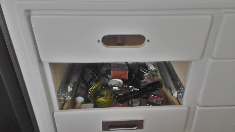

I also spoke to Jason today and they have replaced the short screws with the longer. I ended up pulling the drawers out, checking all of the screws and fixing the sponge drawer by addin a piece of tooth pick to each hole. It is a soft wood laminate with simply the wrong screws. OTT is taking this seriously and has already secured a fix for the trailers still in their inventory. I scored the plywood face easily with my index fingers fingernail.

... OTT is taking this seriously and has already secured a fix for the trailers still in their inventory, and they have already got the new screws, 2 new drawers, and a new mirror in the mail to us, so they are on the ball and making the changes needed immediately. This is a small issue and easily fixed, even on the road. Oliver has made some big changes in the last few years and they continue to do their best to give us the highest quality product out there. These Blum slides are supposed to be the top of the line and as far as sliding, they work great, they looked at my fix today with the extra screws and called me up to talk about the slides. I told them that I like them and also we talked about how to improve them. So Oliver is on it, and there's no worries about that on our end :)

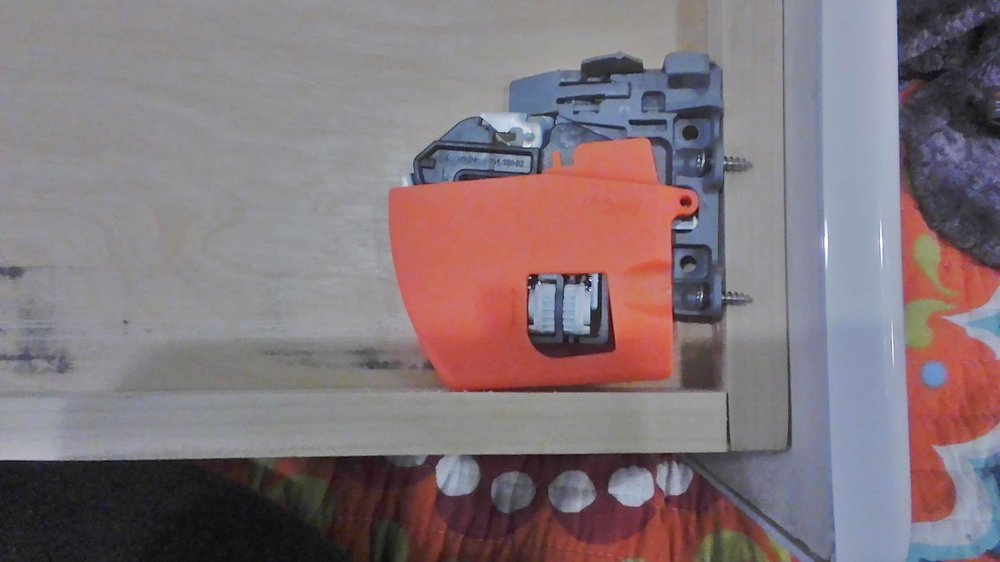

My hull is 140. Picked up May 2016. Could someone summarize what I should be doing to determine if I have this problem? So far, no drawers have fallen out. However one drawer front is loose. I understand the problem with short screws on the closing mechanism, but I get lost after this. Thanks.
If you have the bottom Blum runners with the Orange handle then so far, only the front screws are being replaced by longer ones. You can see if you have the Blum runners by using a mirror to look under the top drawer. If you see this
Then you simply squeeze the edges to open the lock and lift the drawer out and off of the runner. Oliver is replacing the short front screws you can see in the picture with longer screws.
Then on page 1 there are links to 2 youtube videos that go into the Blum runners and how they work extensively if you do have these drawer runners.
Happy Camping,
null
Reed, it's been a long time since I built kitchens, but that clip looks installed backwards (left and right are swapped) you should be able to squeeze the orange clip towards the outer edge of the drawer. And the metal should be up against the side wood.

Reed, it’s been a long time since I built kitchens, but that clip looks installed backwards (left and right are swapped) you should be able to squeeze the orange clip towards the outer edge of the drawer. And the metal should be up against the side wood.
Edit – Sorry, just made the picture bigger and can see that screws aren’t actually attached.
Thanks Randy, I was just showing the screw length :)

They sent us new drawers last week and also a set of longer screws for the other 3. We haven't had a problem since and the new screws are 3/4" full thread so it looks fine. What I did do different was I changed the magnet plate distance on the back of the drawers so that they make full contact with the magnet. Before, they were 1/8" away from hitting.

Well.... The 3 drawers that I fixed work great :) The other 2 below the sink were open yesterday... Lol At least they stayed in. Karen asked me why I hadn't fixed them yet.... My answer was pretty simple... Yes Dear... Lol.
