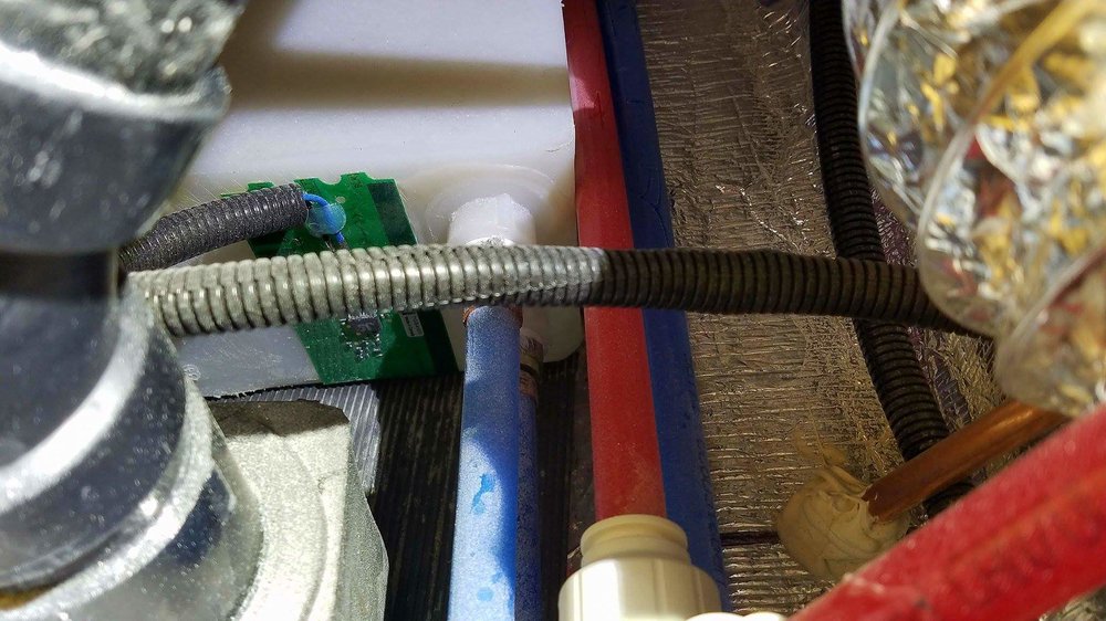

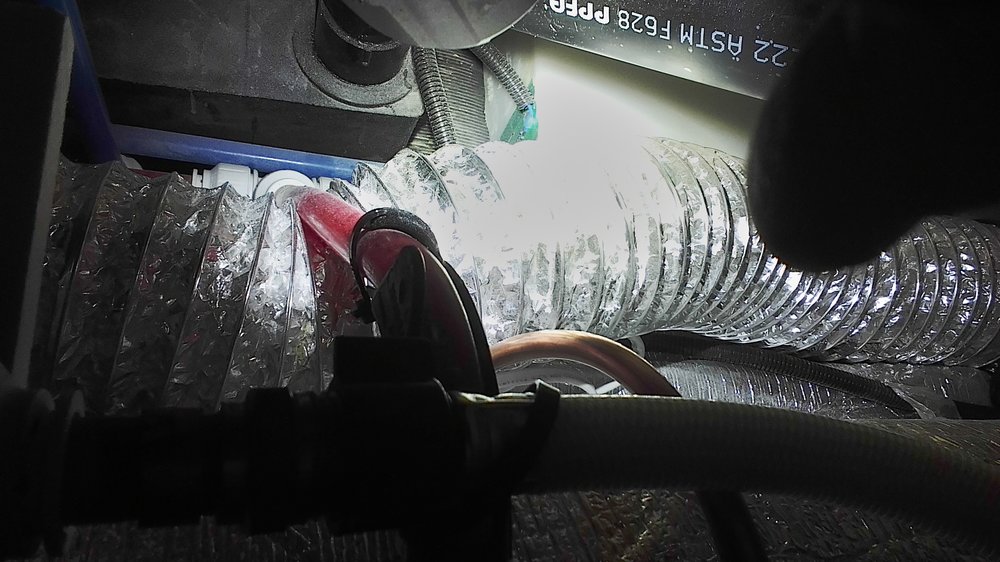

OK, I'm pulling the water tank fix over here to keep everything together. I've talked to Jason and they are looking into it on their end, and I'm going to start talking with them about a permanent fix. I have it worked out, I just need to get started. So you can see here where the water level is by the dark line on the side of the tank. This is at 38% with the trailer perfectly leveled all the way around. Look center top of the pic, the tank is on the right.
Being, we were just filling the tank, we had our hands full... Karen held the flashlight and one end of the hook pole to hold the vent hose over, while I had the phone in hand for this pic, way down inside, while pushing the bottom of the hook pole into place and trying to get a good shot... So she could say, Smile :) ... We didn't have an extra hand to move the electrical cable out of the way to show the level in this next pic, but you can figure it out from the other. What it does show is where the water enters and exits the tank along with the level meter. Notice the water level if you can :) I will get a better pic in a few days. Threading and putting in a pic up tube will be easy, it's just getting everything out of the way to get to that fitting will take a bit of work. Also notice the water level in relation to the water pipe.

OK, I'm pulling the water tank fix over here to keep everything together. I've talked to Jason and they are looking into it on their end, and I'm going to start talking with them about a permanent fix. I have it worked out, I just need to get started. So you can see here where the water level is by the dark line on the side oif the tank. This is at 38% with the trailer perfectly leveled all the way around. Look center top of the pic, the tank is on the right.
[attachment file=57538]
Reed
[attachment file=57541]

Sorry about the double pics but the whole post  disappeared, so I had to copy, paste and usually put the pics in again... Not this time, go figure :)
The bottom pic is a brighter pic of the same place. It is hard to see the water line... I saw the spelling errors above but don't want to have the page go blank again, so please forgive me for letting it go this time :)
To me it looks like the water level is right at the top of the pipe, giving it just enough room to suck in air to the pump from the small gap being left open at the very top of the pipe.
