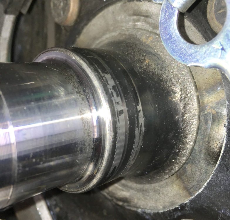

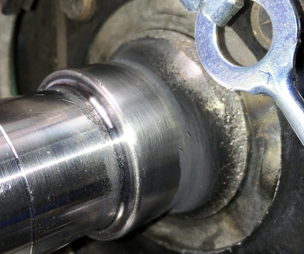

John E Davies Posted August 28, 2017 Author Share Posted August 28, 2017 I took all the hubs off and found a slight grease leak in the one brake that was locking prematurely. I cleaned the bearings, drums, and brake assemblies and everything looked OK, with minimal wear. With a couple of exceptions. Both left axle stubs had some sort of black crusty stuff where the seal runs. I've never seen this before, can anyone comment? I cleaned them both up with a red scotchbrite pad: And I decided to buy real seals, not the crap stuff from China that is sold everywhere. These are USA made, obviously better quality (by visual comparison and at the recommendation of my favorite NAPA parts guy). I had to get them from a bearing supply, cost was $4.59 each. I STRONGLY recommend these for your next brake or bearing service; poor quality seals will mess up your brakes after a few thousand miles. I suggest you order four, throw them in the spares kit and use them yourself, or tell the shop to use them instead of another brand. https://www.amazon.com/Timken-473336-Seal/dp/B001544U88/ref=sr_1_1?ie=UTF8&qid=1503898998&sr=8-1&keywords=Timken+473336 I used Redline Cv2 grease in the bearings, removed the adjusters and lubed the threads with silver antiseize, and sprayed a liquid grease on the cams, magnet pivots and self-adjuster cable guides. I hate drum brakes, they are such a pain to work on. Hopefully they will work right now.... for a while at least. John Davies Spokane WA 1 SOLD 07/23 "Mouse": 2017 Legacy Elite II Two Beds, Hull Number 218, See my HOW TO threads: Tow Vehicle: 2013 Land Cruiser 200, 32” LT tires, airbags, Safari snorkel, Maggiolina Grand Tour 360 Carbon RTT. Link to comment Share on other sites More sharing options...
