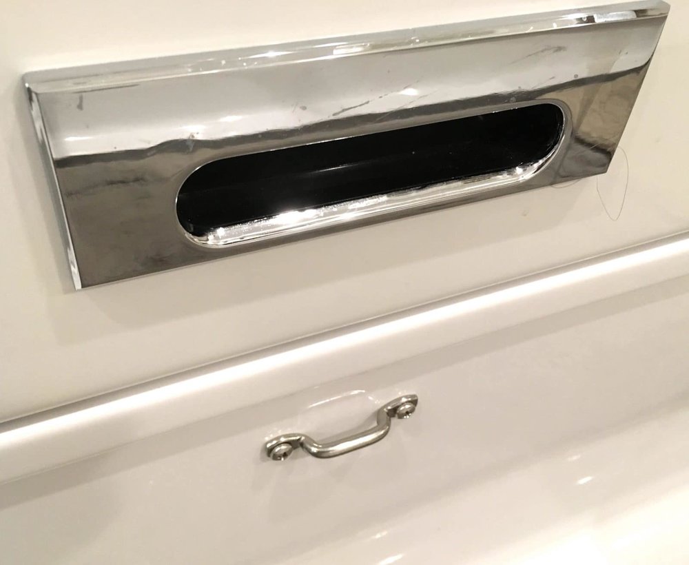

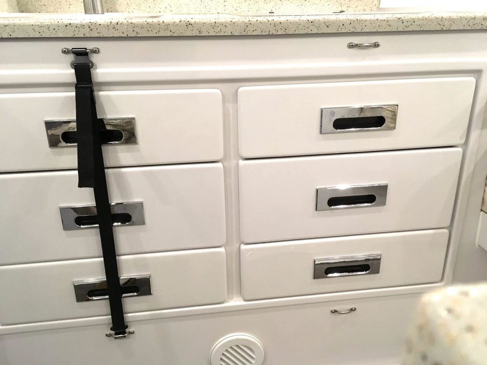

John E Davies Posted August 26, 2017 Posted August 26, 2017 AKA, how to keep your kitchen gadgets inside the drawers when traveling, where they belong. And to keep from busting the latches away from the wood. The standard Soft Close system is cool but totally hopeless in terms of keeping the drawers closed if there is any weight at all in them. Especially on twisty roads where there are repetitive G loads to the left.... Oliver offers some additional latches that mount behind the drawers but they are flimsy plastic, problematic to install and you lose that lovely Soft Close feature. I chose to install 1 inch nylon webbing and stainless footman loops. I chose black since I knew they would be hard to keep clean, and I preferred high contrast so I could see at a quick glance that they were installed and tight... You may prefer white webbing. All the parts are very high quality and came from Raingler Nets. Qty 2: Footman loop 1 inch PAIR. https://raingler.com/products/footman-mount-set Qty 2: Tie down strap 1 inch x 72 inch, with pvc coated flat hook. https://raingler.com/products/tie-down-strap-with-hook Qty 1: Steel flat hook PAIR, pvc coated. https://raingler.com/collections/hardware-accessories/products/flat-hook-set?variant=23658618433 I did swap the plated screws for stainless, and I waited until I was finished to trim the excess webbing. I ended up removing 20 inches from each. That leaves a short length for grabbing and lets you loosen it up enough to unhook and remove each strap, without having to completely unthread the webbing from the buckle. This also keeps the loose hooks from getting lost. When not towing, I store the two straps in the bottom left drawer, which is my electrical/ junk drawer. They work great, and provide good peace of mind when the roads get interesting. John Davies Spokane WA 7 2 SOLD 07/23 "Mouse": 2017 Legacy Elite II Two Beds, Hull Number 218, See my HOW TO threads: Tow Vehicle: 2013 Land Cruiser 200, 32” LT tires, airbags, Safari snorkel, Maggiolina Grand Tour 360 Carbon RTT.
Raspy Posted August 26, 2017 Posted August 26, 2017 That's a very simple and practical way to lock the drawers closed without putting any extra stress on them. I like it. We haven't had any indication that the drawers are opening, but they could be, and I'm also always wondering about the dresser drawer too. We took Ollie on some very rough roads last trip. The dinette window covering fell off and, of course the dinette cushions took a hike. John "I only exaggerate enough to compensate for being taken with a grain of salt." LE2 #92 (sold), Black Series HQ19
John E Davies Posted August 26, 2017 Author Posted August 26, 2017 That’s a very simple and practical way to lock the drawers closed without putting any extra stress on them. I like it. We haven’t had any indication that the drawers are opening, but they could be, and I’m also always wondering about the dresser drawer too. We took Ollie on some very rough roads last trip. The dinette window covering fell off and, of course the dinette cushions took a hike. Our dresser drawer opened and popped the screws out of the wood within the first 50 miles. Whe have not been using it while moving. I am going to install a locking stainless latch in that drawer, the same as the two outside locking compartments. It shouldn't be hard to do, but I am waiting for Winter for that one. I'll start a thread on that mod. The dinette cushions will stay in place if you turn the vertical ones 90 degrees so that they are against the outside wall, slighly wedged under the table. That is our preferred orientation for eating and travelling. They stay in place pretty well. John Davies Spokane WA SOLD 07/23 "Mouse": 2017 Legacy Elite II Two Beds, Hull Number 218, See my HOW TO threads: Tow Vehicle: 2013 Land Cruiser 200, 32” LT tires, airbags, Safari snorkel, Maggiolina Grand Tour 360 Carbon RTT.

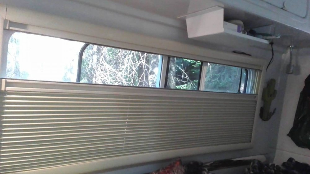

Spike Posted August 28, 2017 Posted August 28, 2017 Since two others have reported window covers falling off during transit, I thought I would ask here if anyone has come up with a way to better secure them. We have had the dinette window cover fall off twice during bumpy rides. Luckily, there was no damage to anything, and we were able to replace the covers, but I don't like worrying about the next time. I've considered adjusting the clips that hold the frame in place somehow in a way to better secure the covers. Has anyone done that successfully? If so, how? Onward through the Fog! EarthPicks of Cochise County
John E Davies Posted August 28, 2017 Author Posted August 28, 2017 I’ve considered adjusting the clips that hold the frame in place somehow in a way to better secure the covers. Has anyone done that successfully? If so, how? The clips on Mouse were installed incorrectly, like so many of the little nuisance things I have been fixing over time There is a thin, very hard plastic spacer behind each steel clip. The installer drilled a small hole straight through the spacer and the window frame, then drove the screw down. Anybody who has installed two parts together will understand why this is so very wrong. The hole in the spacer MUST be larger than the hole in the window, preferably the same diameter as the outside of the screw threads. With a bigger hole the clip will pull down hard and flat against the frame (into perfect alignment). With a small hole the clip can rest at an angle, which prevents the ears from fully engaging the blind frame, and it holds the frame too far out, so the next clip is also less than fully engaged! The frame comes loose there and can fall off during travel. Once all the clips are ALL lying PERFECTLY flat, you can rotate them or bend the ears outward for extra gripping force, and the frames should stay put. I fixed two at a rest break, while my wife and son watched with amusement, on my last trip and I will redrill them all sometime. I was going to do a "How To: REInstall Your Blinds Properly" thread. Maybe you could do that, take pics, otherwise it might start to look as if I am angry about my trailer..... I'm not, really, I love it, I am just increasingly frustrated that one or two sloppy/incompetent/ untrained/ hungover/ part time/ unsupervised/ rushed/ whatever technicians could have screwed up so many little and seemingly insignificant installations that care and common sense would have prevented. John Davies Spokane WA 2 SOLD 07/23 "Mouse": 2017 Legacy Elite II Two Beds, Hull Number 218, See my HOW TO threads: Tow Vehicle: 2013 Land Cruiser 200, 32” LT tires, airbags, Safari snorkel, Maggiolina Grand Tour 360 Carbon RTT.

KarenLukens Posted August 28, 2017 Posted August 28, 2017 I was going to do a “How To: REInstall Your Blinds Properly” thread. Maybe you could do that, take pics, otherwise it might start to look as if I am angry about my trailer….. I’m not, really, I love it, I am just increasingly frustrated that one or two sloppy/incompetent/ untrained/ hungover/ part time/ unsupervised/ rushed/ whatever technicians could have screwed up so many little and seemingly insignificant installations that care and common sense would have prevented. John Davies Spokane WA Now that's funny there, John :) We reversed all of ours the other day so the dark slides up from the bottom for privacy at night. Now we can slide them up at night and leave them open about 6" and see out just fine, but nobody can see what your wearing from the outside anymore. When we removed them, 2 of them had the screws stripped... as usual... and the screws came out with the blinds... then after putting them back on with only 4 hold downs until I fix them... one came down on the road from hell :) but they just land on the bed or on the couch and quickly go back up. I had to realign the hold downs on one when we bought the trailer. Having them all mounted flush and horizontal is the key, and then having them not stripped out helps... It is one nasty road but it cuts off 20 minutes :) The bigger the screw... Lol. Reed 2 Happy Camping, Reed & Karen Lukens with Riffles our Miniature Poodle 2017 Oliver Legacy Elite II Standard, Hull #200 / 2017 Silverado High Country 1500 Short Bed 4x4 Past TV - 2012 Mercedes-Benz ML350 4Matic BlueTEC Diesel Click on our avatar pic above to find the videos on our Oliver Legacy Elite II
Spike Posted August 28, 2017 Posted August 28, 2017 Thanks, John. I will take a look sometime at the spacers behind the clips. What you wrote makes sense. If I do a fix, I'll try to post some information about it as you suggest. However, I wouldn't worry about folks assuming that you are angry about your Ollie. I am sure that they, like I do, find interest in your informative posts and are grateful for them. I have learned a lot from them and from those of other knowledgeable Oliver owners on this forum. --Jeff Onward through the Fog! EarthPicks of Cochise County

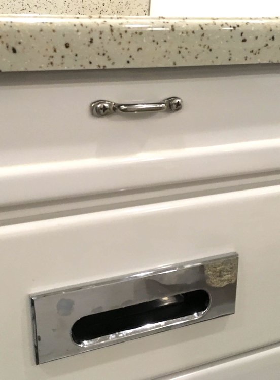

Monlezun Posted September 6, 2017 Posted September 6, 2017 Hello John, Was interested in securing our gallery drawers as you described. Could you tell me what you used to secure the footman loop's on the lower 2. Did you just use a wood screw and go for it blindly, so to speak? I can easily access the top 2 and will use stainless screws with washers and nuts for strength and security. I appreciate your comment and recommendation on this matter. Thanks, Malcolm M. Malcolm and Ursula M. 2017 Legacy Elite II Hull # 204 "Olivia" 2016 Ram 2500HD Diesel 4x4
John E Davies Posted September 6, 2017 Author Posted September 6, 2017 Hello John, Was interested in securing our gallery drawers as you described. Could you tell me what you used to secure the footman loop’s on the lower 2. Did you just use a wood screw and go for it blindly, so to speak? I can easily access the top 2 and will use stainless screws with washers and nuts for strength and security. I appreciate your comment and recommendation on this matter. Thanks, Malcolm M. Hi Malcolm, I used stainless panhead sheet metal screws (not wood screws) at the top and at the bottom. They don't need nuts on the back. The load on those screws is really really low. Unless you plan to fill the drawers with horse shoes or ammo.... Drill a pilot hole the size of the minor diameter (unthreaded part), or slightly larger, and then countersink lightly. The gel coat will not chip and the screws bite down really hard. I swapped the supplied plated screws for stainless, from Ace. I think they are 10 x 3/4", basically whatever is a snug fit in the holes. I have been using these straps for a few trips now and they work great. No issues at all, other than remembering to install them before towing. John Davies Spokane WA 2 SOLD 07/23 "Mouse": 2017 Legacy Elite II Two Beds, Hull Number 218, See my HOW TO threads: Tow Vehicle: 2013 Land Cruiser 200, 32” LT tires, airbags, Safari snorkel, Maggiolina Grand Tour 360 Carbon RTT.
Monlezun Posted September 6, 2017 Posted September 6, 2017 Thanks for your quick response John. We are leaving in 2 weeks for Zion and Grand Canyon with fellow RV'ers and want to get this done before the trip. I have the straps and footman loops on order and expect them very soon. Again, thanks for this great fix for a concern I have had for a while. We have had the drawers fly open while traveling and found the mess on the floor. Not fun when some of the spill was spices and seasonings. Not a happy wife! We have reservations for the 2018 Rally and hope to meet you and so many fellow Oliver owners to thank them for all the input to better serve the experience. 1 Malcolm and Ursula M. 2017 Legacy Elite II Hull # 204 "Olivia" 2016 Ram 2500HD Diesel 4x4
DavePhelps Posted September 6, 2017 Posted September 6, 2017 John Davies wrote: "Drill a pilot hole the size of the minor diameter (unthreaded part), or slightly larger, and then countersink lightly" This should be emphasized whenever drilling holes in gelcoated fiberglass. The countersinking is an especially important detail that takes no time at all. Oliver really needs to start doing this as there is fractured gelcoat around every mounting hole I have looked at. The pilot holes have been undersized and not countersunk, not good practice, and so easy to do it right to begin with. For exterior holes, the countersink also creates a thickened area of sealant around the fastener, which creates a much better weather seal. Any boat builder who knows what they're talking about would say the same. Dave 1 1 2015 Oliver Elite, Hull 107 1998 Ford E-250, 5.4 liter
