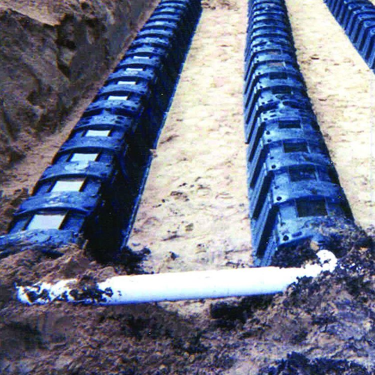

I installed an 1100 gallon septic tank and used sections for my field.  They are about 3' wide and 2' and make up about 150' of leach field.  There is no way they are going to clog up.  Since the Oliver tank is only 18 gallons or so, I figure we could easily exceed that amount in a day with regular household use.  Plus we are gone a lot and the system has a lot of time to process what is in the tank.  Doesn't seem like a problem unless we happened to add some destructive chemicals, which we don't.
