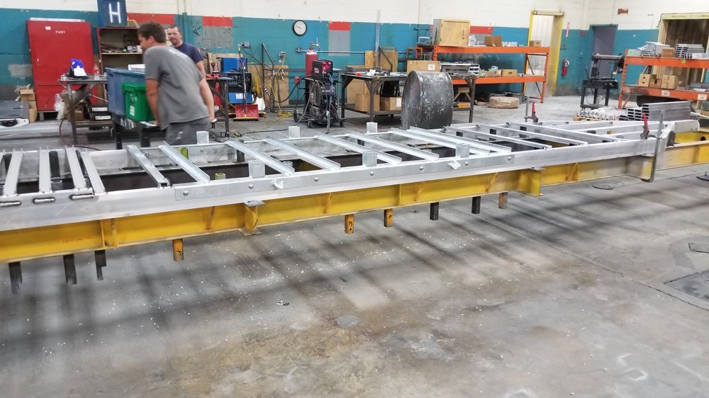

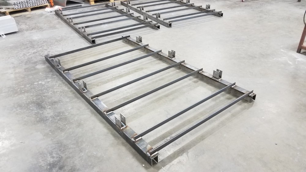

 Where “is the steel section of the subframe”? A picture would be nice.
Is the section that all of the suspension components are attached to, steel plate then?

KountryKamper:
According to your July 2017 picture of the steel subframe; the U shaped steel frame looks to be about 12 inches longer than where the spring hangers are installed.  On our 2015 Elite II the U shape steel subframe extends about one inches past where the spring hangers are installed.  Because of this short distance there is no space where a jack stand could be placed on the subframe when doing maintenance on the wheels.
