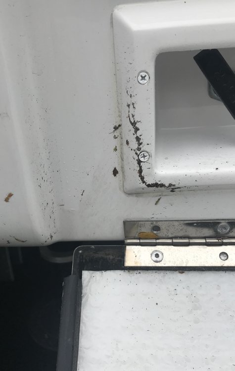

Townesw Posted June 11, 2018 Share Posted June 11, 2018 What have you all done to keep road spray out of the basement? 1 Bill and Martha 2018 LEII Hull 313 2019 Chevrolet 2500HD Duramax Link to comment Share on other sites More sharing options...

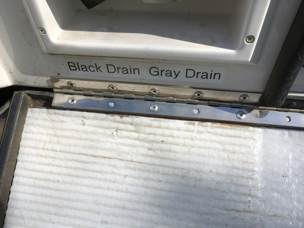

Moderators topgun2 Posted June 11, 2018 Moderators Share Posted June 11, 2018 I never had the "problem" that it seems you've got, but, I did add an extra layer of insulation and some extra weather strip in that area - mostly just because I had it laying around. The insulation I used was Reflextic https://www.amazon.com/Reflectix-BP48010-48-Inch-10-Feet-Insulation/dp/B000BPAULS/ref=sr_1_2?ie=UTF8&qid=1528721831&sr=8-2&keywords=reflextic+insulation&dpID=31Io%252BmGxiWL&preST=_SY300_QL70_&dpSrc=srch And the weatherstrip was closed cell foam from Walmart. That basement door was a bit tight just after I added these things, but, now it is snug and nothing gets in there. Only downside is that the aluminum facing on the Reflextic leaves marks on the shower compartment door. Bill 2 2017 Ford F150 Lariat 3.5EB FX4 Max Towing 2016 Oliver Elite II - Hull #117 "Twist" Link to comment Share on other sites More sharing options...

Townesw Posted June 11, 2018 Author Share Posted June 11, 2018 Steve, the door is plenty tight. The water is entering where there is no seal. Don’t know why the factory would leave a gap like that. Bill and Martha 2018 LEII Hull 313 2019 Chevrolet 2500HD Duramax Link to comment Share on other sites More sharing options...
STEVEnBETTY Posted June 11, 2018 Share Posted June 11, 2018 Looking closer at your picture, I see what your talking about with the bottom corner of the door with no gasket in place, I just walked out and checked mine, it's the same as yours. I haven't had the amount of leakage as you're experiencing. Adding gasket material like bill did would seem to be the best fix, but I don't know about reflectix, automotive weather stripping would seem to be more appropriate. 2 STEVEnBETTY Link to comment Share on other sites More sharing options...
Moderators topgun2 Posted June 11, 2018 Moderators Share Posted June 11, 2018 I only put the Reflextic over the area that was already covered by that white insulation that was installed by Oliver. The weather stripping filled in the gaps that Bill & Martha show in the picture plus I simply continued with that same stripping all the way around - just because. Bill 2 2017 Ford F150 Lariat 3.5EB FX4 Max Towing 2016 Oliver Elite II - Hull #117 "Twist" Link to comment Share on other sites More sharing options...

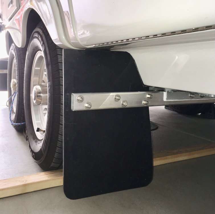

John E Davies Posted June 11, 2018 Share Posted June 11, 2018 I too found a large gap in the bottom seal, letting in dust and spray... I added a strip of 1/4 inch black high density foam rubber weather seal there, from Lowes. I also tightened the latch about a half turn. Be sure to seal the entire section of piano hinge, plus the open gap at the front. I think maybe they wanted to leave a way for water dripping out of the shower area to escape....? Even sealed up pretty tightly, I think enough would trickle out to alert you of a plumbing problem. Plus water trickling out after you use it will run down the inside of the door, instead of down through the open hinge, so leave the head hanging to the front until it has quit. Mudflaps on the trailer will help too, and if extended up to the underside of the hull, they are extremely effective in keeping road debris from eroding and contaminating your fresh water connections. Why they leave these completely exposed to road damage baffles me. At the very least they need a stainless guard/ deflector in front of them. This shows the mudflap, before I added the extra foam over the hinge. I positioned the rubber so it comes up to the hull. In the first pic, the door has flexed the flap forward a little http://olivertraveltrailers.com/topic/how-to-rear-mud-flaps-for-the-ollie/ EDIT: found a pic of the dust entry, before sealing. John Davies Spokane WA 2 "Mouse": 2017 Legacy Elite II NARV (Not An RV) Two Beds, Hull Number 218, See my HOW TO threads: https://olivertraveltrailers.com/topic/john-e-davies-how-to-threads-and-tech-articles-links/ Tow Vehicle: 2013 Land Cruiser 200, 33" LT tires, airbags, Safari snorkel. Link to comment Share on other sites More sharing options...
