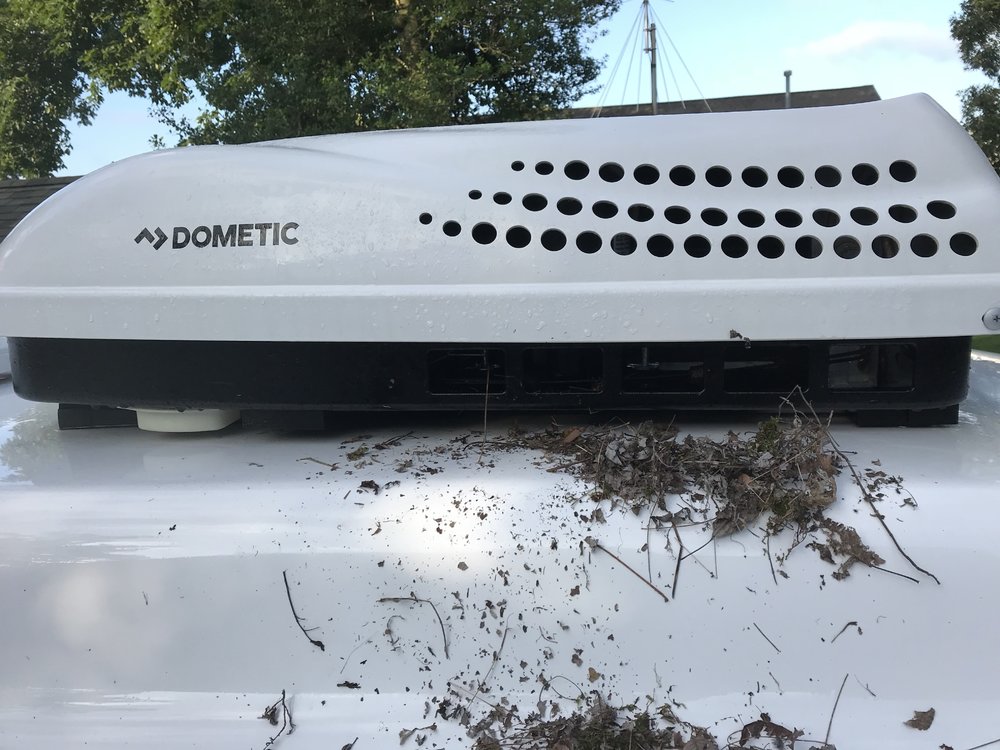

My wife and I brought home her new Oly and a birds nest in the Air Conditioner Unit. It is unknown if the Birds came along for the drive to NJ.  We were late picking up her camper due to my medical condition and the Oly was stored outside for several months this last spring.  I was advised to remove the outer cover and blow out the offending nest. Sounds easy enough I guess? Anyone had a similar issue if so what length of ladder did you use ? don't really want to do a header off the top of the Oly'' and is there a bird screen that can be  purchased for the Air Conditioner? Any help would be appreciated.........Yukon

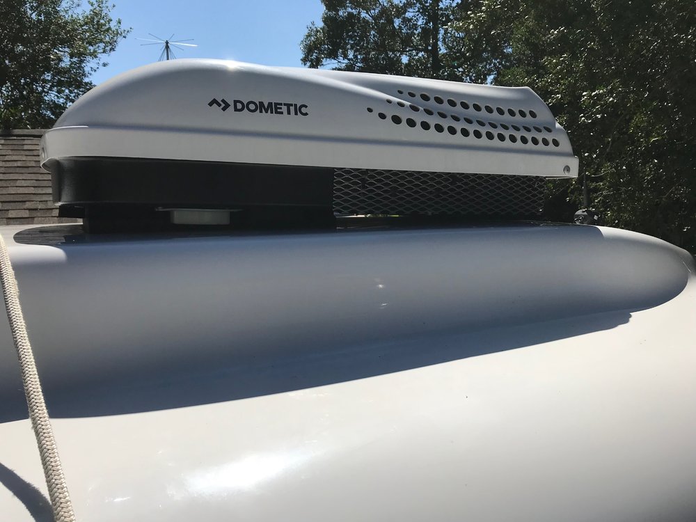

Yes, a nest was built in mine while at a campsite for just three nights. I had to take the cover off to get the best out. Just four Phillips screws to remove the cover. I used my Telesteps ladder on one side and 6ft. step ladder on the other. The cover is very light and I removed it without getting on the roof. I used 1/4 x 1/4 hardware cloth to make the three pieces necessary to cover all of the large openings and I attached them with black cable ties. The two side pieces (left hand and right hand) are bent in 90deg to cover both vertical and horizontal openings, and one piece at the rear to cover the vertical openings. I wouldn’t use anything with smaller openings like window screen material as I would think that it could cause excessive airflow restrictions.

Thanks for everyones help'' will give me a excuse to purchase a new safer ladder . all good ideas.  I have to say the A/C unit does look like a bird' condo, I bet when the birds arrived in NJ they started to fly south due to the high property tax .IMG_1874.thumb.jpg.83edffd8464f1b3b9b9dbe8a4bf3b5fd.jpg
Thanks for that suggestion. I found a nest, cleaned it out, and put the cover back on. The next day, the nest was back. I felt sorry for the birds' wasted work but took the new nest out and left the cover off for a couple of days to discourage further attempts. I need to get back up there before next spring to implement mountainoliver's solution.

I installed some stainless grading .5 inch with marine wire ties , this should keep the wrens out thats the plan anyway!.......Yukon
