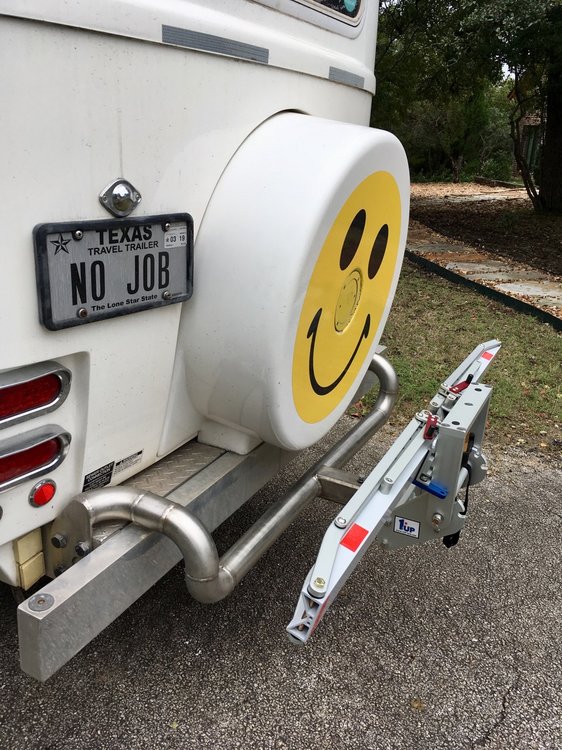

Let me show you his creation . . .
It started with two machined stainless steel brackets for the exterior of the frame, cut to permit the bumper to swing down without interference. The brackets each had three holes to accommodate a 5/8 inch hardened grade 8 bolts.  Inside the frame, he added six solid blocks of aluminum which had also been drilled for the 5/8 inch grade 8 bolts.
Using stainless steel curved tubing with a 2 inch ID, Rob measured the angles required to ensure clearance would permit access to the rear bumper compartment and spare tire.
Finally, he made a 2" receiver, curved exactly for welding onto the stainless steel pipe.  His artistry at welding is evident in the finished product.  After applying a brushed finish to the exterior of the hitch, Rob installed it onto The Wonder Egg.  The hitch fits the rear portion of the frame perfectly and each of the six grade 8, hardened steel bolts was snugged down with 200 ft lbs of torque.  I feel very confident in the ability of this custom hitch to do the job.

This just blows me away. You can’t buy a 2 inch receiver tube in stainless, I have looked, so no worries, he just welded one up from 2” plate...
He even gave you a threaded hole for a tensioning bolt.... I would comission him for any custom work, without any reservations.

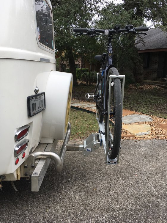

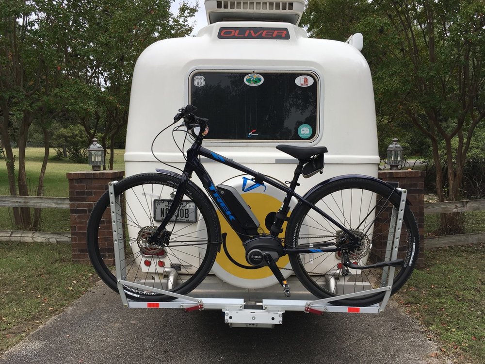

Here are some pictures of the hitch with a bike rack and loaded bike.  The rack I chose was the 2" Super Duty Single, by 1UP USA.  It does not require additional tie down points for the bike and the bike is held rock solid over bumps and exhibits no wiggling at all. It can be expanded to hold up to 3 bikes.
I appreciate the ease of loading and unloading, no need for tie-downs, and the great clearance from the ground and trailer.
Pete
ps Larger pics added . . . (The 1UP-USA rank is not safety pinned into the rack, it is secured through an internal tensioning bearing which is built into the rack)

Pete, that rack is a great choice - it is definitely one of the very top choices..... But your pics are teeny - can you try uploading bigger versions?

Cool, that is gorgeous. Are your tail/ brake lights adequately visible? Have you thought about adding some extra small ones on the back of the rack?
The LED tail lights are really bright.  I am betting these will do adequately for me.  I will let you know if "Mr Smokey" ever tells me otherwise.

Pete,  Thanks for sharing.  We have e-bikes and the same American rack that you do.  Total weight would be about 175 lbs. and I just don't trust the Oliver bike rack bracket.   I was considering having them upgrade me to the newer version.  Be very interested to hear how you make out with this.  Would you please give us a "ride" report after you have a few hundred miles with the rack.
I considered putting some kind of bungee set up on the bikes in case the American arms loosened up.  Those ratchets are pretty strong but you never know.
