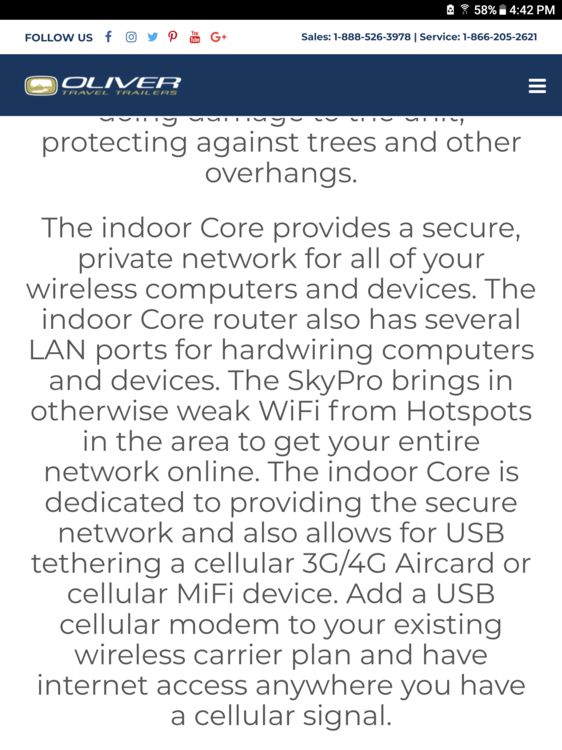

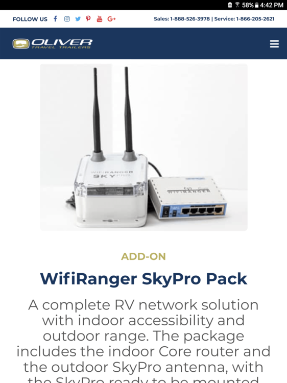

We don't have the WiFi but under options on Oliver's website it says the router is part of the system. I believe they locate it in the front upper cabinet.

If your trailer had the WiFi Ranger installed by Oliver, there should be two routers. The Sky router is mounted on the roof and includes an antenna. The other router, the Go2, is inside the trailer, and is usually mounted inside the cabinet above the dinette, maybe next to the bathroom. I also got the Weboost Cellular Booster, and it is mounted at the other end of the cabinets above the dinette. The rooftop Weboost antenna and the rooftop Sky router are mounted at opposite ends of the trailer, to minimize interference between the two.
It is quite useful to have two interconnected routers. The Go2 interior router is best for use inside the trailer, while the Go2 outdoor router is best for web surfing when outside the trailer in the campground, or, say, by the river. The manufacturer says that the outdoor router can transmit 250-1000 feet. More importantly, the outdoor router can connect with, and amplify, distant WiFi signals such as from the campground, as much as 1.5 miles away. I read a report online where someone was boon docking a mile from a Flying J, without obstructions, and was able to connect to the Flying J WiFi via their WiFi Ranger.
