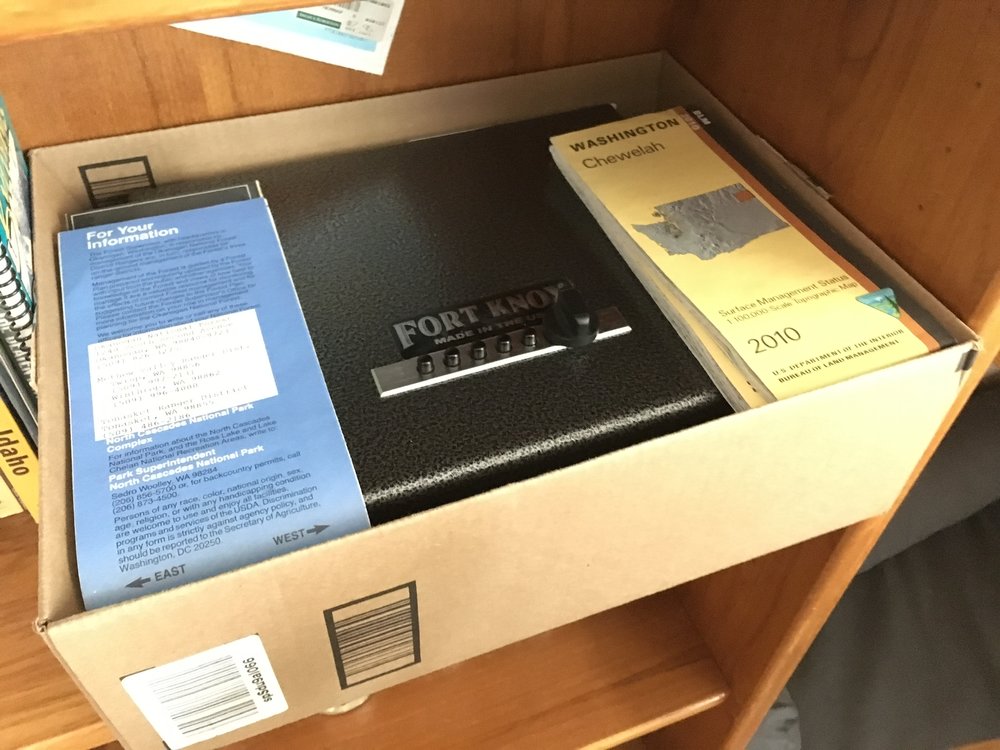

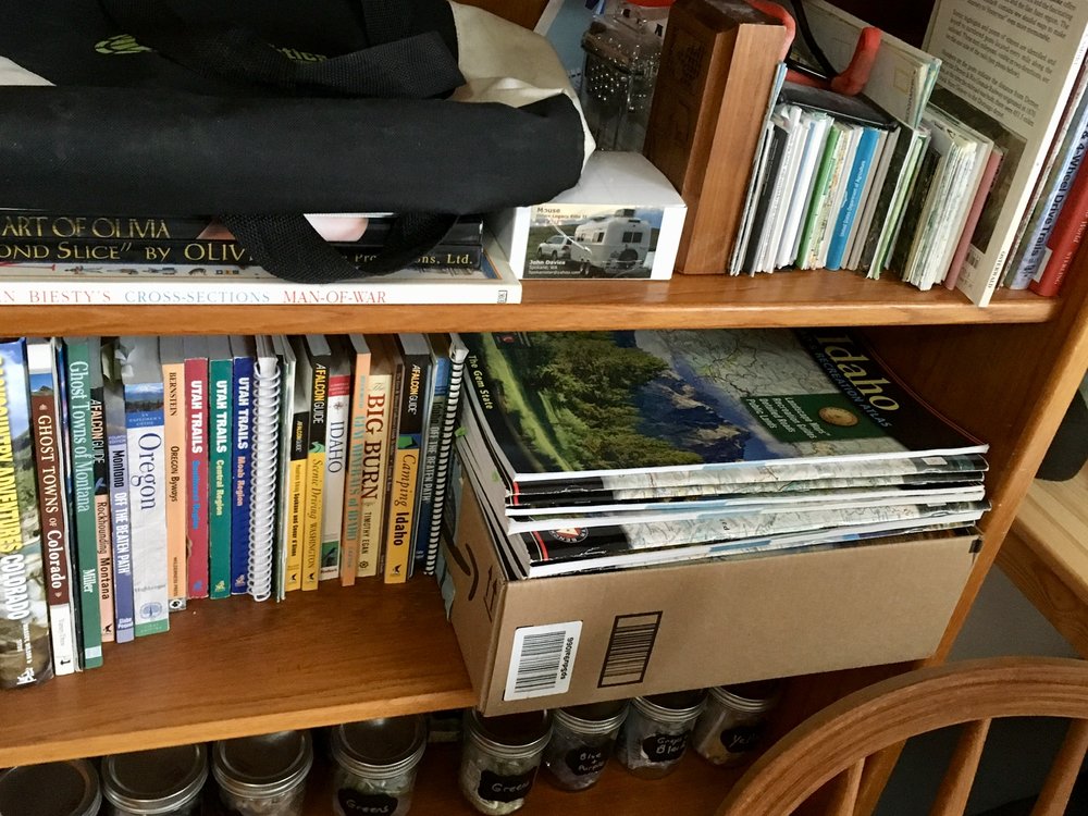

I got this one for Christmas, to comply with the new state “secure gun storage” law, and it is a real dandy. Highly recommended. ...https://www.gunsafes.com/Fort-Knox-PB1-Original-Pistol-Safe.html
It is installed onto a fixed bookcase shelf inside a cardboard box, through bolted with 3/8” bolts, with “red herring” road atlases and travel magazines piled on top. It looks like a pile of old junk but is very quick to access the contents.
