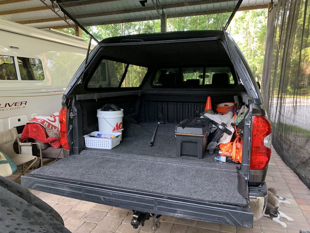

This Tundra is a pleasure to drive and a truck is so very convenient, even without an Oliver.  My wife (Karren) is a Master Gardener and steals my truck to haul her plants and gear in the back. We added a LEER topper, with carpet and sliding pet screen windows for our dog (he loves jumping into the back and going for a ride).  I am certain you will be just fine in this Tundra and likely wonder how you ever got along without a truck in your life.  This truck is in excellent health - everything dealer serviced and well kept (I have all the service records).  Not a bit of trouble.

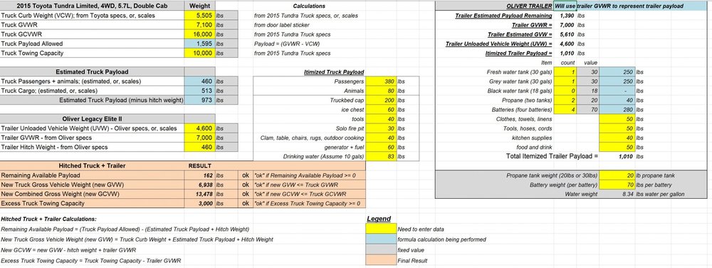

Originally, as I struggled with understanding payload considerations, I built the attached Excel spreadsheet.  My apologies for the layout (I realize it is confusing).   In general, any yellow-shaded cell requires an entry and the blue cells have formulas, and the orange cells provide results.  You are able to test various payload weights and the Excel sheet will determine if the weights are within limits.

Not sure you are missing very much not being able to access my Excel sheet.  I believe there are on-line calculation tools for determining payloads.  I built the sheet simply for me to play around with payloads to determine the effect on towing.  Attached is a picture of the sheet using my payloads.

Nan , Ken's Tundra looks like a great truck fo you. The Leer canopy is a high quality fiberglass unit and is attractive when color matched like this one - I had one on my last truck. It provides secure storage and improves highway mileage. The overall truck specs are great, the tow package is a huge plus (the axle ratios are 4.30 which gives more power), you will enjoy the Limited trim interior and seats, the only thing we don't know is if it has the standard gas tank or the big one. Probably the former, in which case you will be stopping more often to refuel in mountainous terrain. On an Alaska or Yukon trip it could be a worry, and you might have to bring an extra 10 gallons in cans. (Changing the small tank for the bigger one sourced from a scrapyard would be possible, I think, for not too much money.)
However I don't believe you ever told us how much your animals weigh and how much personal stuff you plan to bring along. As with any light duty truck, weight is always going to be your primary and constant concern. If you want to bring a bike, generator, normal camping stuff and a small generator, it will be no worries. You can't pack this truck with six adults and their luggage and still have enough leftover capacity for the trailer load.....  for a solo traveller that is a non-issue. But I would caution you to keep the trailer tongue as light as possible - do NOT order the tongue cargo tray. A rear rack for a bike is fine and actually lightens the front significantly. Your enemy in this situation is weight in the bed and weight on the hitch.... keep them light.
Have you thought about how to carry your dogs? In my Ram 3500 I removed the rear seats completely, that frees up over 100 pounds of payload. I built an elevated wood platform with hidden storage under the hinged plywood. I used a Pet Loader (folding steps) to get my two 40 pound Labradoodles in and out, it is way too high for them to jump and it is awkward to lift them that high. A cargo net separated them from the front seats so they were secure. A pet hammock and door guards kept the interior claw and drool free.
But there was lots of drool on the glass...
