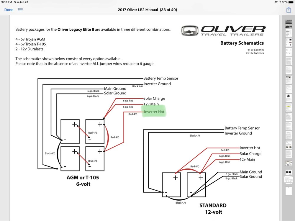

This is from the 2017 LEII manual and it may help your next step.
THANKS!
I  just about ready to correct my post of "SUCCESS!" because I could not get the inverter lug on that post with the other two lugs attached. Thanks to you, I will now try putting it on the post indicated by the Oliver diagram. I AM a bit concerned, nonetheless, because a yellow sticker on the battery informs me that the screw posts are NOT to be used except for low-current applications. I supposed that powering an inverter might not be a low-current application, but was then puzzled why the lug was obviously set up to be attached in that manner. I will now suppose that powering the inverter via the screw post is OK. I am going back outside now to attach it to the post indicated by the diagram. Thanks again.

Here you go. I think that I failed to understand that you were talking about the same screw post that mossemi revealed in the diagram he shared. Please critique.
Thanks for your help and patience. All seems to be working. So glad I didn't have to deal with a fried inverter. Still puzzled by the loose cable.
