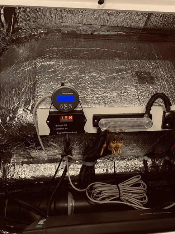

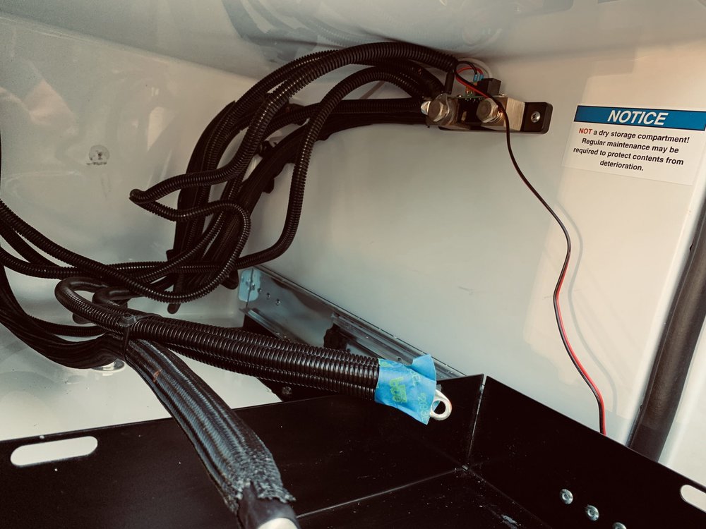

The solar panel install went so smoothly yesterday I woke up this morning with the energy to finally tackle the battery monitor install I had been postponing for months. I think I am going to just leave it by the EMS monitor for now just because it is easy to use via bluetooth in the Victron Connect app.

Agreed - there’s nothing on the display that isn’t easier to access and read on the app. Same for the settings. There are a few oddball things that you need access to the controls for, like if you ever replace your batteries and want to reset everything, but otherwise there’s no need to run the wires and cut another hole in your interior.
Their color control is a different story, since it displays so much info at a glance, but I wouldn’t think that’s something you’d install unless you at least added a Victron solar charge controller.
I agree completely but what changed my mind is having to fish the VE.direct cable2 x2  down to it, wasn't an easy task today going up with the communication cable. So once the battery monitor goes up top (so that I can run VE.direct cables from the controller and battery monitor to Color GX)  I thought I might as well install it showing rather than leaving it in the cabinet.
But I would guess the app will be used 90% of the time. So if I wasn't going to add the Victron solar charger and Color GX I would definitely leave in the basement.
