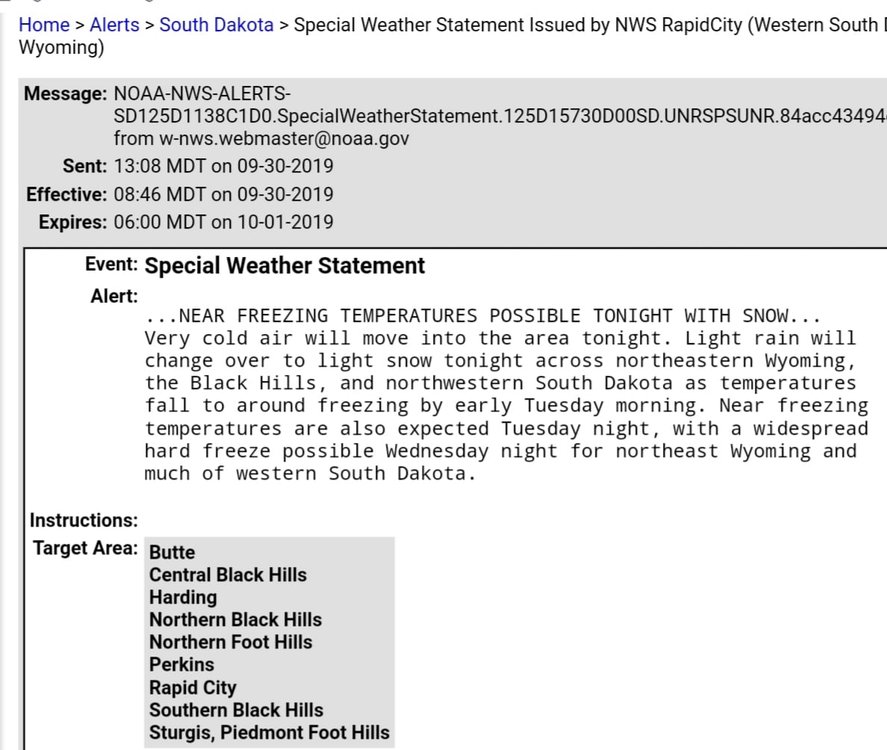

Thank you everyone. Perfect timing. We just arrived at Custer SP & were wondering the same thing. I think we're ready.
