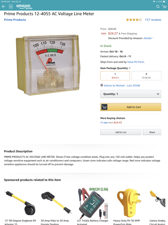

I keep this meter plugged into the AC outlet under the street side bed for informational purposes. I think of it as a gas gauge for the trailer AC electrical system. I can do a quick visual check on the AC power in the trailer without have to get a multimeter out of my tool kit.
The outlet I plug into at the house is a 15 amp circuit and it has several outlets in the garage as well lights. If I try to run too much on that circuit, the house breaker may trip or the trailer air conditioner may stop if it is running or the refrigerator will switch to gas when it is set on auto mode. These are all indications that my house circuit is overloaded and if I reduce the load on that circuit, the trailer is happy and everything runs as expected.
