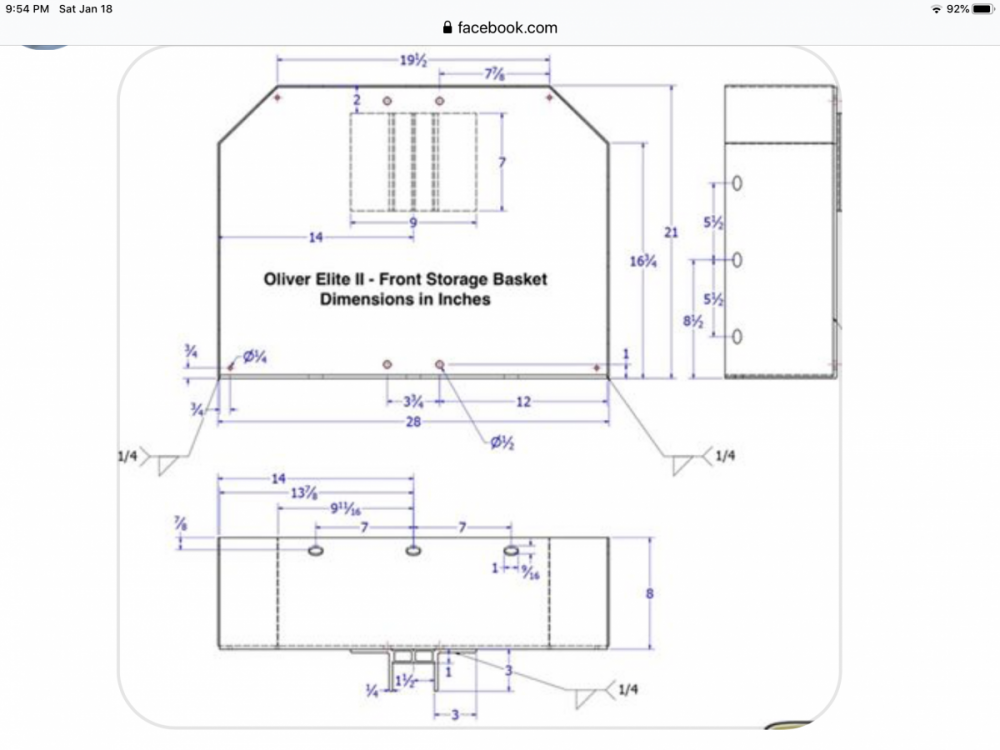

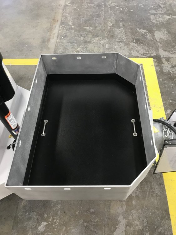

I have the attached tray dimensions, and after reviewing dimensions of my Honda Handi eu3000i it should fit nicely with it measuring only 13”w x 22”L. I was Just curious if anyone who carries this gen in the tray and may have crafted a unique way to securely lock it down in the tray. I will craft something.
I may have a local boat cover craftsman make a snap on cover for traveling, weather, keeping it a little lower profile/out of direct view.
-David

David, what is your tow vehicle? Loading down the tongue that much is acceptable if it is a HD truck. If it is a lighter one or an regular SUV (not for example, an old Excursion) you will hate what it does to your marginal payload. I think the actual tray is factory rated for 140 pounds, but considering the way it is attached with just two ubolts along the centerline, I would never put that much in it.

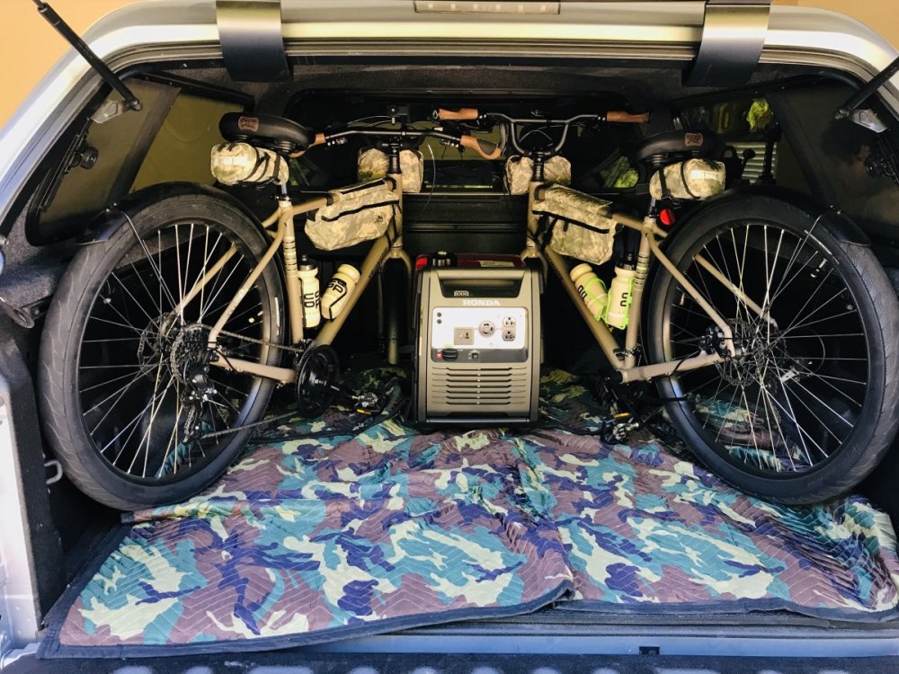

Good points. We own a Tundra Platinum Crewmax. I use to carry the eu3000i in the bed between the bikes when hauling our former camper. I will have to see how the basket handles 78 lbs be just setting the gen in it. If it’s not up for the weight, and it might not be, I will revert gen storage back to the truck bed.
Thanks,
David
Edit- Thanks for advising me on the load weight limit of 140 lbs on the tongue box John. At 78# I think it will support my Honda fine while camped.

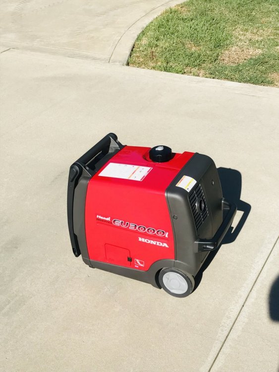

Quite capable indeed, and Honda whisper quiet and reliability to boot. We have owned Honda power products for years. They have served us very well. The 7000 in this photo with a gentent cover is our temp whole house back up gen. The Handi will run our new Oliver with ease.
