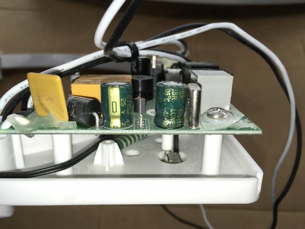

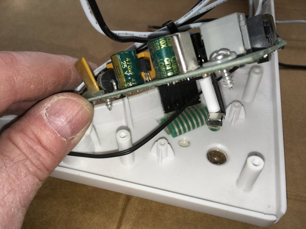

John E Davies Posted February 27, 2020 Share Posted February 27, 2020 (edited) FYI here are pics of my board. Check Youtube, there is a video by a guy who repaired and modded his due to condensation damage. The IR sensor for the remote extends down into a clear bubble. I don’t think you would necessarily have to do his entire mod, but drilling a tiny drain hole there is mandatory. IMHO. John Davies Spokane WA Edited February 27, 2020 by John E Davies 1 SOLD 07/23 "Mouse": 2017 Legacy Elite II Two Beds, Hull Number 218, See my HOW TO threads: Tow Vehicle: 2013 Land Cruiser 200, 32” LT tires, airbags, Safari snorkel, Maggiolina Grand Tour 360 Carbon RTT. Link to comment Share on other sites More sharing options...

John E Davies Posted February 27, 2020 Share Posted February 27, 2020 BTW, the guy in the video camps in -30 degree F temps, for us mere mortals, especially those in a dry climate, his coating mod is optional. For those Ollie owners who routinely winter camp in frigid temperatures, do this! John Davies Spokane WA SOLD 07/23 "Mouse": 2017 Legacy Elite II Two Beds, Hull Number 218, See my HOW TO threads: Tow Vehicle: 2013 Land Cruiser 200, 32” LT tires, airbags, Safari snorkel, Maggiolina Grand Tour 360 Carbon RTT. Link to comment Share on other sites More sharing options...
