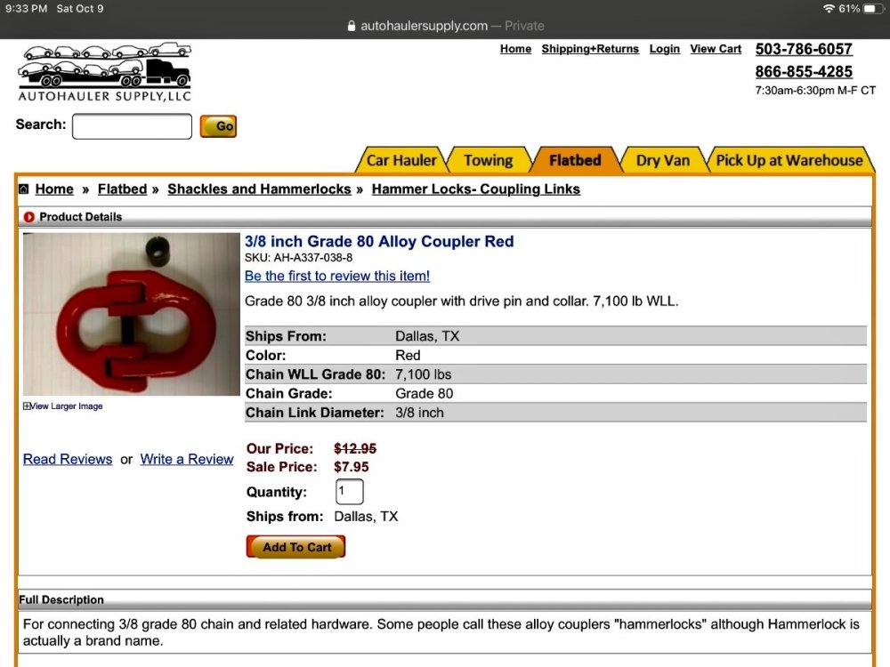

GJ and topgun2,  I would suggest you re-think you F150 safety chain connection.  The quick links you are using are rated at 3300 lbs. WLL and I believe  a single trailer safety chain should be rated for the weight of the entire trailer.  I am sure you have seen postings here on the forum about the Anderson WDH's with chain extensions connected with 3/8” quick links failing.  Have you explored hammer links?  If not take a look below to see an example and compare the safe WLL.  They would solve your F150 safety chain connection safely.
I  just carry a couple of 1/2" quick links for this purpose. They're strong enough and  also fit the safety chains hooks and hitch loops better.
Correct.  That's exactly what my last sentence hinted at.  I had not seen the Hammer or Dura Links.  I loved the review comment from Amazon Qwork links:  "Perfect for Ford owners and those with a hitch developed by a desk jockey."  That reviewer hit the nail on the head.
Do you use the 7100 WLL or 12,000?  I assume both would work with our safety cable hooks?

Actually, Patriot put me on to the "hammer links" several months ago.
Unfortunately, I've still not done anything about it.  My bad!
I use 3/8” safety chains with a 24,000 lb. breaking strength with hooks that fit my Toyota so I don’t need hammer links, but if I did need either of them, I would buy the size that my hooks would fit in as either size would meet my safety requirements.
For the Andersen chain extensions, I used 3/8” heavy duty twin link clevis repair links with a working load limit of 6600 lbs.
Maybe Patriot will chime in with the size he is using with his F250 Tremor that topgun2 referenced above.
This LINK will take you a different brand, but it does provide size information for your reference.
