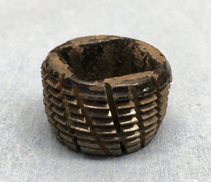

Or if you have some tools, you can pick up a $2 steel pipe plug with no protruding hex head, and make your own thread chaser. I found an old plug in my junk box, put it in the vise, and uses a hacksaw to cut angled grooves. The grooves are needed so the rust and crud will have somewhere to go as you turn it into the hole. I use water from a squirt bottle as a lubricant. This is actually much easier to use than an actual tap, since you can just stick a 1/2” drive extension into it.
Flush out any debris with your rinsing wand and dry the area before installing the replacement anode rod with a couple of wraps of thick plumbers teflon tape. It will not leak. Try not to leave any loose crud in the tank or it will gradually travel to your water pump screen. Clean and lube your tool before you put it away or it will rust.... LOL. Mine already looked like that.
