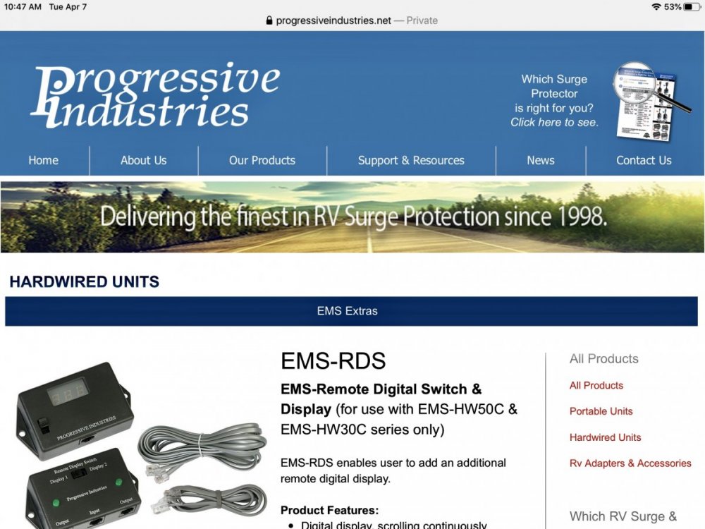

Something like this would make sense. Or maybe an outside display, or at least one visible outside. We have a portable EMS and like that we can tell immediately if there is a problem, before even plugging in. We don't have to go inside to see why or what might be the problem. I do have to lock it down, so it doesn't get "borrowed".
642F628F-BBB2-4063-A9DF-1EEFCCB5DADD.thumb.jpeg.6e109a403c4e2aa7e58ee2dfd0ec4968.jpegYou could add a remote display from Progress Industries to your existing surge protector or move the existing display to the battery box or the basement.
