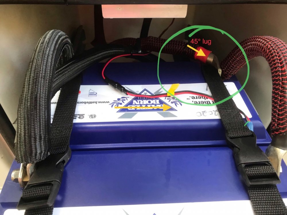

Moderators mossemi Posted October 7, 2020 Moderators Posted October 7, 2020 On 10/1/2020 at 4:33 PM, mjrendon said: Thank you to everyone that replied. I am going to cancel the order for the BB GC2 cells. I have measured my tray/compartment and it has inside dimensions of 14"W x 21"D x 12.75H to the aluminum block for the door latch. Overland's photo verifies that the standard batteries work without any modifications, other than the custom cables needed for the connections. Does that black tubing contain the main lines to the distribution panel and solar? There certainly no end to the different types of lugs in the link that bhncb posted. What tooling is needed to make your own battery cables? I installed 2 standard Battle Born batteries, but prepared for a 3rd in the future. One problem I ran into was with the positive battery cable would not lay correctly with a straight lug. I replaced it with a 45° lug which routed the cable toward the cable gland instead of the back wall, which reduced the strain on the battery terminal. Good luck, Mossey 2 Mike and Krunch Lutz, FL 2017 LEII #193 “the dog house”
