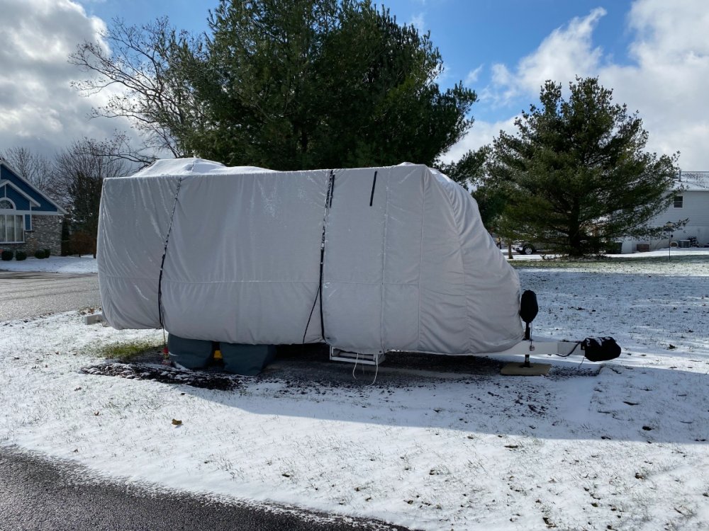

Calmark cover.  And a couple of the Damp-Rid buckets inside the camper to absorb any excess moisture, but it’s always extremely dry inside the camper if there’s nothing inside to generate moisture such as people breathing or cooking.

1) Calmark.  Pre-Oliver I did use a similar brand but even though they are about the same price and use the same material I believe that the Calmark is the better cover.  This is due to the fact that the Calmark has a cinch rope at the bottom (along with grommets) and two or three straps that circle around the entire camper - see the black vertical straps in  FrankC's pic above.

Calmark cover.  https://calmarkcovers.com
Frank, Thank you for sharing, very helpful. I have noticed a hydraulic jack, do you lift trailer up for storage and keep it on stands of some sort?
I just level the trailer with the standard Oliver electric stabilizers and that takes a little bit of load off of the tires.  No other stands or jacks used.  But I haven’t had any problems yet with the tires getting flat spotted after last winter storage.  Wheels & tires are covered to protect them from exposure.  And the trailer is plugged into a house AC power outlet to keep the batteries charged.   It is a two person job though to get the cover on the trailer.  It’s a lot of fabric that is pretty clumsy to handle.  And I have not seen any signs of chafing or scuffing of the fiberglass gel coat finish caused by the cover (and I inspect my trailer very careful all the time when I wash and wax it during camping season).
