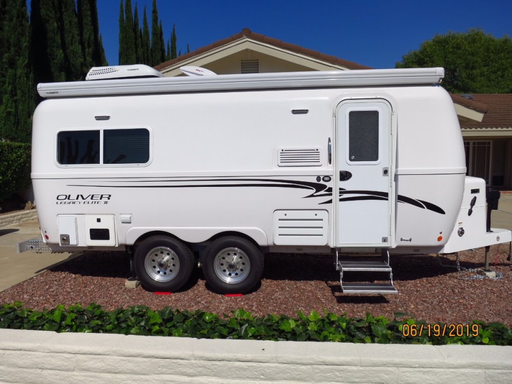

Lori,
Here is a picture of regular and metal flake black.  If we had it to do again, we wouldn’t pay extra for the metal flake, as it is very difficult to see any difference between the two.
Andrew

We chose black graphics, as well. We've towed our 2008 Elite with three different vehicles (so far), three different colors.
Black and white work with any color. Like a tux, or a black cocktail dress..
And, works in all seasons.

AndrewK and SeaDawg--thank you for the pictures.  I think black will work the best with my truck color.
