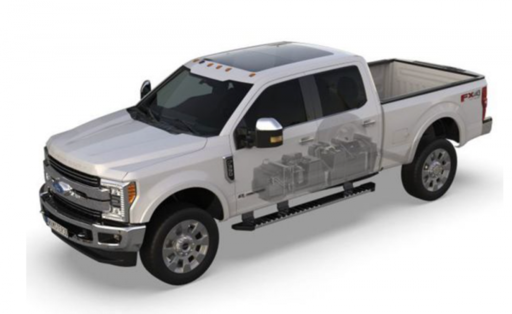

I recently upgraded from a 34 gallon stock fuel tank to a 60 Gallon S&B Fuel Tank.
The install was into our 2021 F350 6.7L Crew Cab/Short Bed. It fits in midship as shown in the image below from the S&B Tanks Site:
1389379940_ScreenShot2021-02-12at10_24_30AM.thumb.png.c87b5a9c4f3d1a1dfaded8a9282f4da9.png
As part of the upgrade process, I needed to use Forscan to update the "fuel tank size" so the dash display correctly displayed distance to empty.
