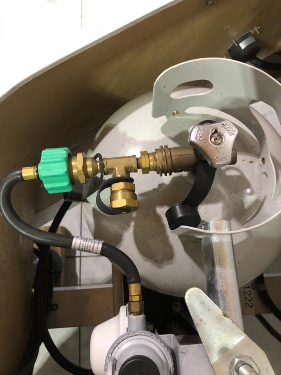

Here is the set up I use instead of the propane quick connect. Simple easy to install . With a 20ft hose reaches just about anywhere. Works with all appliances and only cost about $35.00 minus the hose.

The connection to the tank is to the "Y" connector....similar to what I see in Landrover's pic.
One three point connector and one hose to the stove or any other appliance that has it's own regulator.
Could you tell me where to find the parts or the whole tee?  Thanks Foy
Im interested in the parts you used to make this.
Do you need to turn off the tank, then connect your hose so propane doesnt escape escape or is this T a "quick" connect like system?
The only way I ever make the connection to the tee is shut off the tank valve first for safety. Attach your hose then  attach the hose to  what ever appliance you are using turn the tank valve back on. Make sure your appliance is also turned off before you turn the tank valve back on  When your done with the appliance keep it running  turn off the tank valve this  will  empty  any propane left in the line,  Diconnect the hose and turn the propane back on. Very simple steps.  I think you have to do the same for the quick connect you turn off the valve at the connection  before attaching your  hose and appliance in stead of turning off the tank valve same steps. Hope this helps.   The  tee valve you can get on  amazon best price  $20.00
All I am seeing is this 3 way "Y" type valve. The ends dont have any caps for them, so it seems like this wouldnt work as gas would just escape if a third appliance wasnt connected.
Do you have the link for what you got?
2021 Oliver Legacy Elite II - Twin Bed - Hull 762 | 2018 F150 3.5L Ecoboost V6 w/ Max Tow package
Link to comment
Share on other sites
Jordanv
i think your looking at the other post picture. Y connection my set up is inline and you can only connect one appliance.  The tee stays connected inline.  Sorry i cant link you the picture from amazon. If you look at my picture easy to match it up on amazon. I will say there are many different types of connections offered. This is the one that best works for me. Thanks
