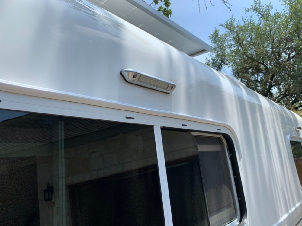

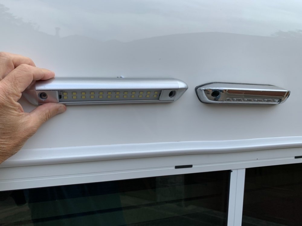

I replaced my porch light with these.  They are about the same size as the originals but the housing is aluminum.  I also ordered some rubber sheeting and cut my own gaskets.

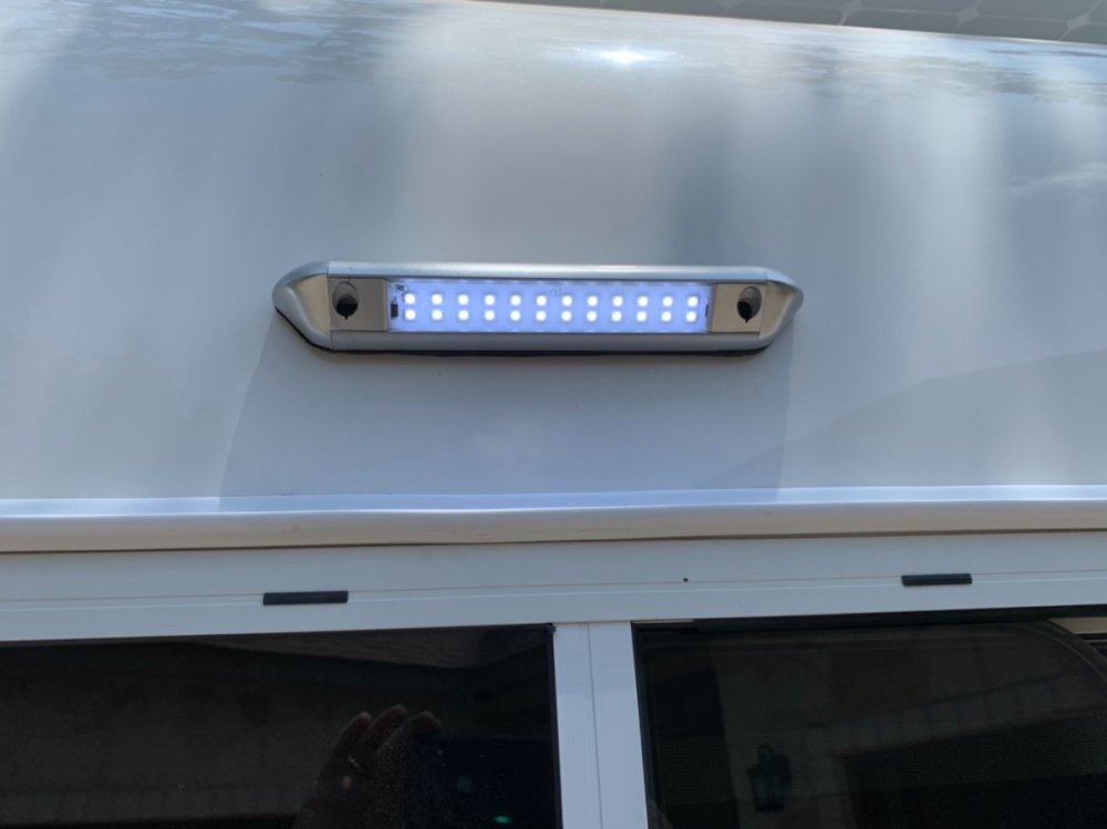

Here they are mounted.

Just a follow on - the holes for the screws on the replacement lights are just slightly farther apart, so I had to drill one hole for each light.  Quite a traumatic experience.  Mike

I tried to tell you that 2 inch hole saw was going to be too big.
