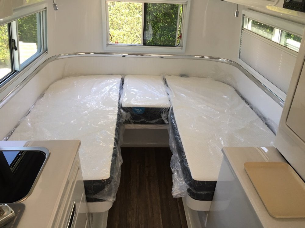

AndrewK Posted September 28, 2021 Share Posted September 28, 2021 3 hours ago, MrLynn said: Thanks Bill & Andrew— Andrew, did you elect not to install the night table that the current promo photos show between the twins? —LEJ MrLynn, I did, as I am 6'5" and sleep on my back. I need the center fill-in mattress to have enough room for my shoulders and arms. The dog likes it too! Keep in mind, the two twin bed rails cost $535 from Oliver. I can only imagine how much the nightstand would be. Andrew 1 Andrew 2019 Legacy Elite II 2018 BMW x5 35d Link to comment Share on other sites More sharing options...
