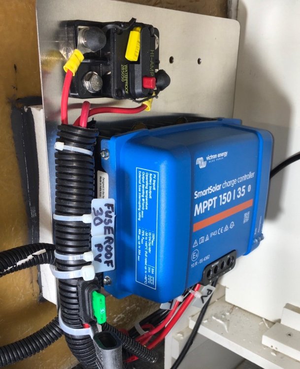

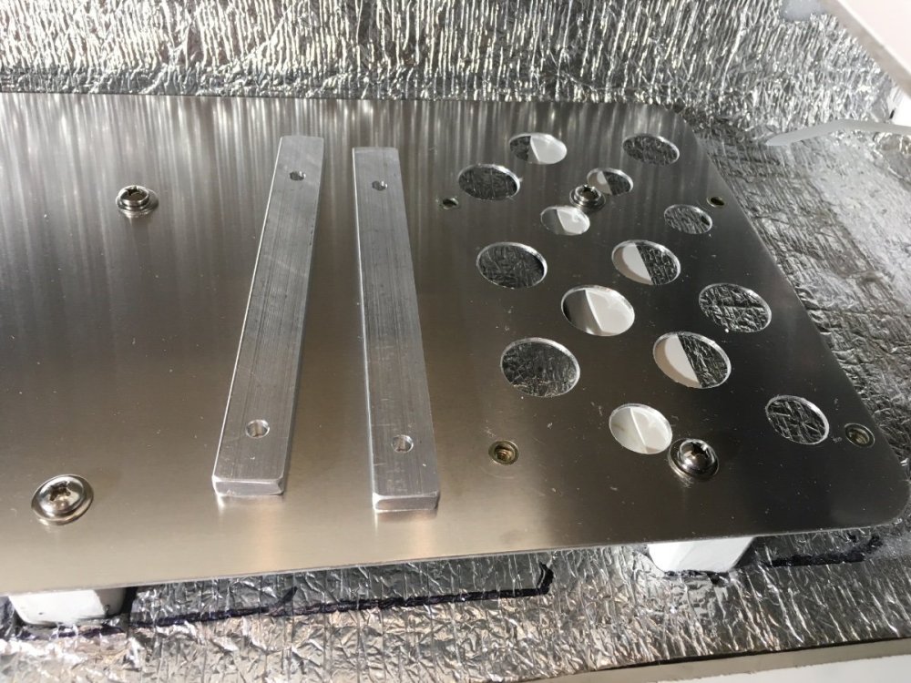

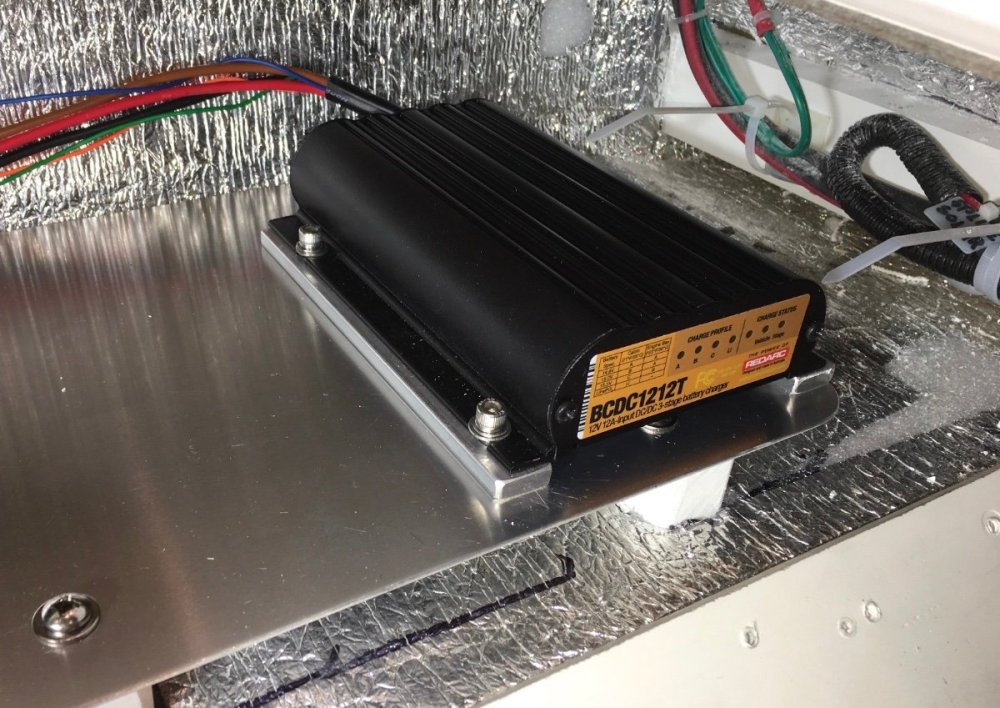

I suspect assembly problems at the factory, if the pilot holes are drilled too large, the screw threads will not hold. Mine are doing fine after five camping seasons. I used the same material in a 1” thickness to add additional mounting plates, I bonded the HDPE to the fiberglass with JB Weld, then screwed 6061 T6 aluminum to that with stainless sheet metal screws. As an ex A&P tech, structural aluminum is my material of choice, I won’t add any more wood to my Ollie, no way.

Does anyone know how those platforms are attached to the trailer? I just went out to measure thickness and it certainly seems like they are glued/epoxied on. Might have to come up with something other than ripping them out and installing marine-grade plywood. Perhaps a metal plate as shown above which it then itself epoxied to the MDF-like thing that's already in place.

I don't know about attaching electrical stuff to aluminum plates.  Most of those components will have chassis grounds, which means that when you screw them to the plate, the plate will have a path to ground as well, and if a positive wire comes loose, there's a good chance it's going to land on that plate.  Sparks, melted aluminum and all that.  If you do it, I'd use some good strain relief on all the wiring (which you should do anyway - I see so many people dismiss that step).
The fuse will fail before anything nasty will happen. That is why ALL hot leads should be fused appropriately. Some Ollie battery cables are not fused between the battery and the main fuse block. This would be an issue if a cable shorted out to the steel tray (which could happen).  My 2000 watt inverter has a 250 amp one, the bigger inverters have a much high rated fuse (350?). You could have some serious sparks and burning before it popped. I added individual fuses at each battery positive post, just in case....
I agree that aluminum does conduct, but planes have used it for mounting stuff since pre WW2.
