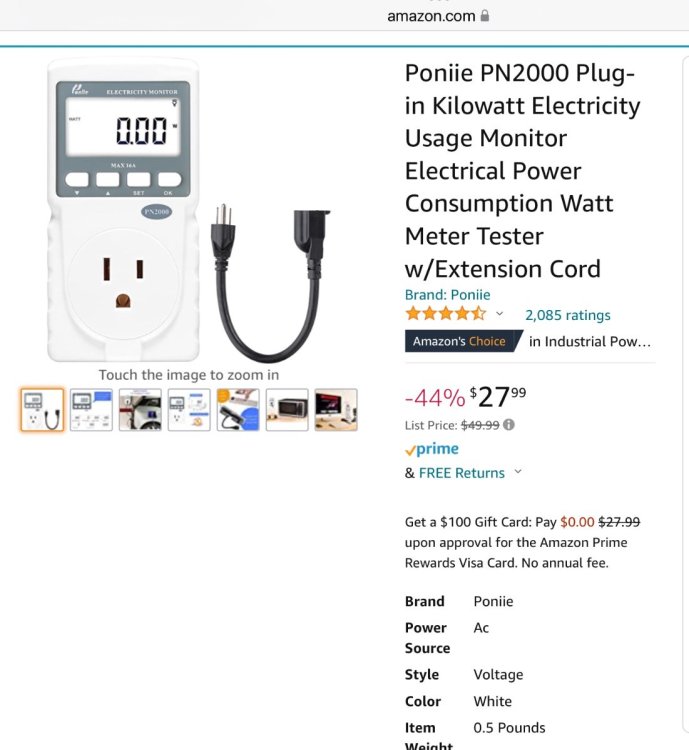

John E Davies Posted January 15, 2022 Share Posted January 15, 2022 I can’t answer your question, but I do suggest that you calculate how much energy is consumed over a week or more at home, then you can calculate an average daily figure. Once you have that number, somebody here can help you figure out how long the Ollie’s lithiums will last. There are endless choices for an energy/ watt meter, I have this one and it works fine. Poniie PN2000 Plug-in Kilowatt Electricity Usage Monitor Electrical Power Consumption Watt Meter Tester w/Extension Cord https://truckersinsider.com/how-many-watts-does-a-cpap-use/ John Davies Spokane WA SOLD 07/23 "Mouse": 2017 Legacy Elite II Two Beds, Hull Number 218, See my HOW TO threads: Tow Vehicle: 2013 Land Cruiser 200, 32” LT tires, airbags, Safari snorkel, Maggiolina Grand Tour 360 Carbon RTT. Link to comment Share on other sites More sharing options...
MarkC Posted January 15, 2022 Author Share Posted January 15, 2022 Thanks John! Will get that monitor and post our using in a few weeks. Link to comment Share on other sites More sharing options...
