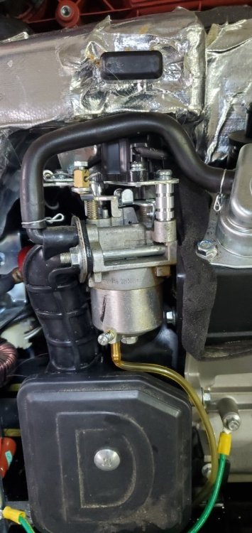

For my $20 Powermate model PMO152000 inverter generator, Powermate was no help when I called them as they do not deal parts and gave me the name of the local small engine repair shop. Powermate even gave me the incorrect part number for the carb. Luckily I have the owner's manual which gave the correct part number. The local small engine repair shop used my part number from the owner's manual and gave me a price of $86.00, and it is back ordered by the supplier.
I initially ordered it but decided to cancel the order for a new carb until I gas up the generator and give it a try myself. As Mainiac suggested, I will use some starting fluid sprayed in the carb if necessary.
I did find that the engine is a 2015 Ducar engine. (Made in China, but had good ratings.) I searched online and also at Amazon to match up my carb if I need to purchase one. I looked at a lot of pictures on Amazon but I had no luck there finding a match.
If any of you mechanicss out there can help identify this carb, I would very much appreciate it. Below is a picture of the carb.

Is that the right way up?
yes, thanks Bill.
