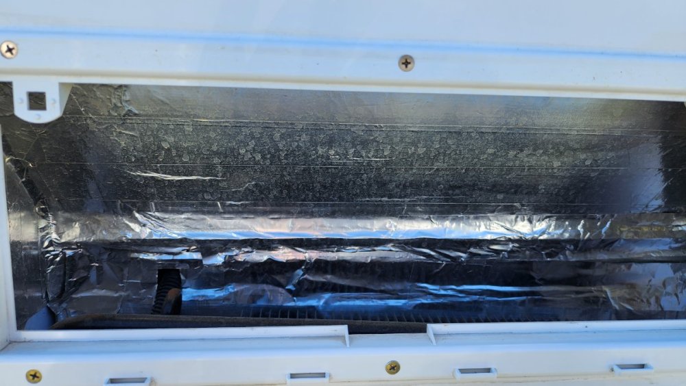

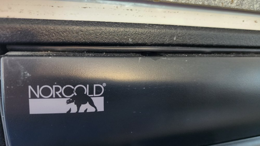

Gliddenwoods Posted March 17, 2023 Share Posted March 17, 2023 On 5/19/2022 at 6:10 AM, johnwen said: I submitted this to OTT On 5/19/2022 at 6:04 AM, johnwen said: AHAAAAA!!!! After lying around all night I came up with the idea of approaching this problem from another angle 🙂 I took a very bright light, at night, and shone it from the top of the control panel on the front of the refrigerator, inside the trailer, and there it was plain as day as I looked through the upper vent from the outside......it is an improper mating of the fridge and the cabinet, at the top of the unit. My guess is that the fridge frame is not compressing the combustion seal and there is a gap between the two. Anyway, at least I can identify the problem with the aid of my flashlight. Now, to get it fixed will be next! John I also have alot of wind entering my Oliver at the frig. Sounds like this topic was brought to Oliver's attention by others; was a solution found? 2022 Oliver Legacy Elite II, Hull 1242, 9/26/22 Lithium Platinum Power/Solar Package Tow with Supercrew Cab 2019 F-150 4 x4, 5.0L 4-Valve V8 with 3.73 axle ratio & 157" wheelbase. F-150 GCWR of 16,900 lbs with maximum load trailer of 11,500 lbs. Link to comment Share on other sites More sharing options...
johnwen Posted March 17, 2023 Share Posted March 17, 2023 No solution as far as I know. I'm not saying or suggesting you do what I did as the warranty will be nullified according to Norcold and OTT, but I taped over the space between the cardboard on the outside and put foam insulation around the control panel, inside, and got the breeze to stop in the cabin. Norcold told me the space is for air circulation. I looked at previous models of the Oliver 2's with the same Norcold unit and there is no space visible from the outside as a foam block resides on top of the fridge and is completely taped up with foil tape. Since the Norcold models were the same as mine, I figure if there are no issues with theirs, which there weren't (as I checked with the owners), I'll take my chances with my fix. That was 9 months ago and my unit operates the same as before my "fix". We've experienced +15 to 105 degrees during that time. My unit is now 15 months old. If I prematurely age the unit I'll replace it when I have to. I'm just saying how I finally addressed the issue and am NOT suggesting you do what I did. No more breezes and fumes! And, of course, no more warranty. John Oliver II #996 "Bessie", 2019 Silverado LTZ 5.3, Veterans https://wenandjohnsadventure.com/ Link to comment Share on other sites More sharing options...
Gliddenwoods Posted March 18, 2023 Share Posted March 18, 2023 5 hours ago, johnwen said: No solution as far as I know. I'm not saying or suggesting you do what I did as the warranty will be nullified according to Norcold and OTT, but I taped over the space between the cardboard on the outside and put foam insulation around the control panel, inside, and got the breeze to stop in the cabin. Norcold told me the space is for air circulation. I looked at previous models of the Oliver 2's with the same Norcold unit and there is no space visible from the outside as a foam block resides on top of the fridge and is completely taped up with foil tape. Since the Norcold models were the same as mine, I figure if there are no issues with theirs, which there weren't (as I checked with the owners), I'll take my chances with my fix. That was 9 months ago and my unit operates the same as before my "fix". We've experienced +15 to 105 degrees during that time. My unit is now 15 months old. If I prematurely age the unit I'll replace it when I have to. I'm just saying how I finally addressed the issue and am NOT suggesting you do what I did. No more breezes and fumes! And, of course, no more warranty. John John, I spoke with Mike at Oliver and he also states that there is no real offical fix. However we did discuss some wind blockage unoffical options. Could you please share a photo of your fix as I am finding it difficult to fully understand it. It would be most appreciated. Thank-you. 2022 Oliver Legacy Elite II, Hull 1242, 9/26/22 Lithium Platinum Power/Solar Package Tow with Supercrew Cab 2019 F-150 4 x4, 5.0L 4-Valve V8 with 3.73 axle ratio & 157" wheelbase. F-150 GCWR of 16,900 lbs with maximum load trailer of 11,500 lbs. Link to comment Share on other sites More sharing options...
johnwen Posted March 18, 2023 Share Posted March 18, 2023 4 hours ago, Gliddenwoods said: John, I spoke with Mike at Oliver and he also states that there is no real offical fix. However we did discuss some wind blockage unoffical options. Could you please share a photo of your fix as I am finding it difficult to fully understand it. It would be most appreciated. Thank-you. Will try to get it to you tomorrow. Oliver II #996 "Bessie", 2019 Silverado LTZ 5.3, Veterans https://wenandjohnsadventure.com/ Link to comment Share on other sites More sharing options...
johnwen Posted March 19, 2023 Share Posted March 19, 2023 On 3/17/2023 at 8:09 PM, Gliddenwoods said: John, I spoke with Mike at Oliver and he also states that there is no real offical fix. However we did discuss some wind blockage unoffical options. Could you please share a photo of your fix as I am finding it difficult to fully understand it. It would be most appreciated. Thank-you. Sorry for the delay...was havin' too much fun :) The thin weatherstripping, from Lowes, has adhesive on one side, was somewhat of a challenge to get installed. Put on top and both sides of control panel. 1 Oliver II #996 "Bessie", 2019 Silverado LTZ 5.3, Veterans https://wenandjohnsadventure.com/ Link to comment Share on other sites More sharing options...
John E Davies Posted March 19, 2023 Share Posted March 19, 2023 41 minutes ago, johnwen said: Sorry for the delay...was havin' too much fun 🙂 The thin weatherstripping, from Lowes, has adhesive on one side, was somewhat of a challenge to get installed. Put on top and both sides of control panel. Did you cover this hole with aluminum tape? The outside vent “system” should be completely air tight. That prevents propane gas and air leakage into the cabin and also keeps out bugs. Can you post a link to the seal you used? Thanks. John Davies Spokane WA 2 SOLD 07/23 "Mouse": 2017 Legacy Elite II Two Beds, Hull Number 218, See my HOW TO threads: Tow Vehicle: 2013 Land Cruiser 200, 32” LT tires, airbags, Safari snorkel, Maggiolina Grand Tour 360 Carbon RTT. Link to comment Share on other sites More sharing options...

johnwen Posted March 20, 2023 Share Posted March 20, 2023 10 hours ago, John E Davies said: The outside vent “system” should be completely air tight. That prevents propane gas and air leakage into the cabin and also keeps out bugs. I agree, John, but Norcold says differently. Sorry but I don't have a link, the weatherstripping was in an open container. I did use a metal foil tape. I'll probably go back and completely cover the hole you circled in your post. Thanks, John Oliver II #996 "Bessie", 2019 Silverado LTZ 5.3, Veterans https://wenandjohnsadventure.com/ Link to comment Share on other sites More sharing options...
