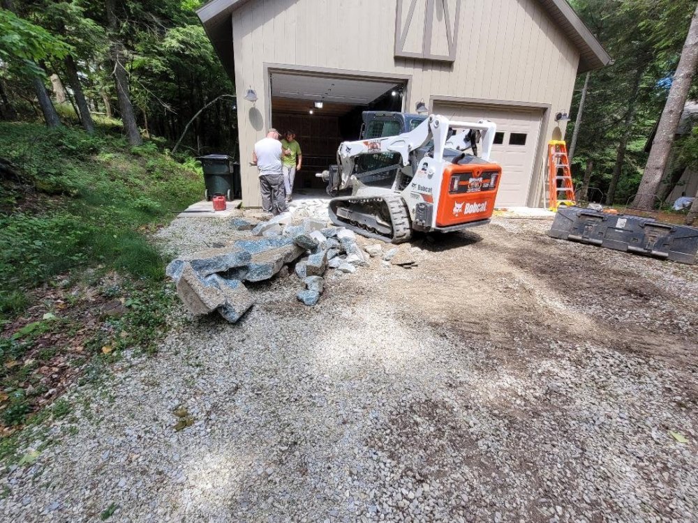

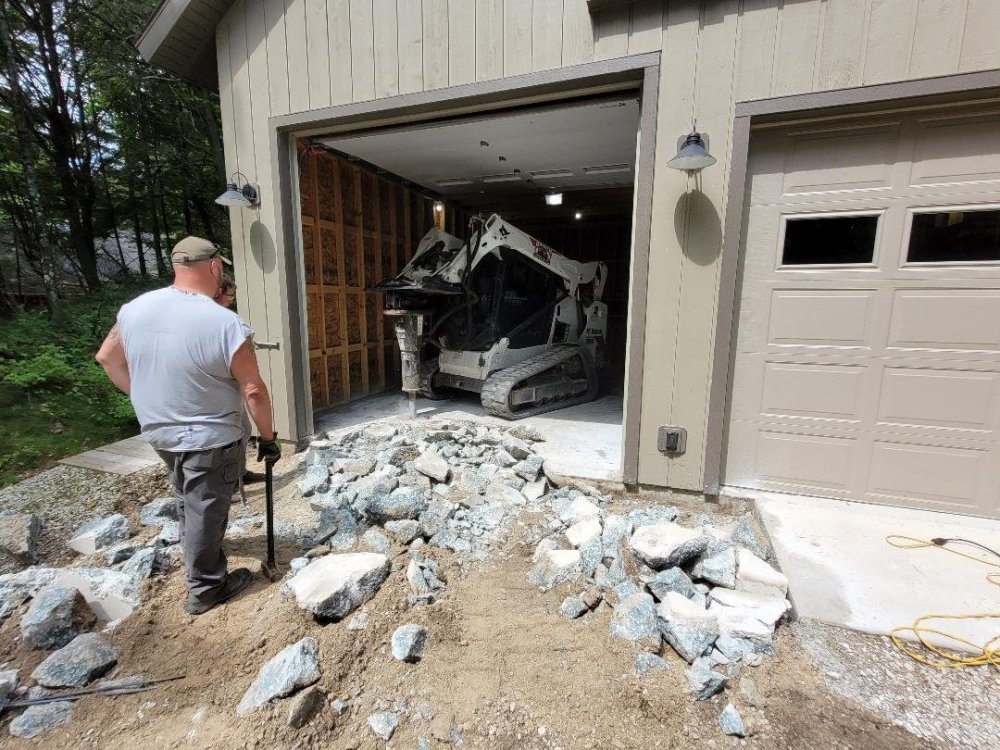

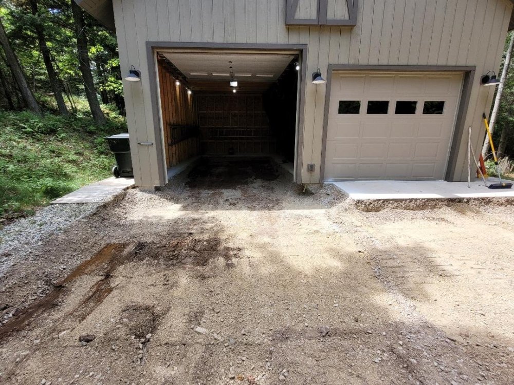

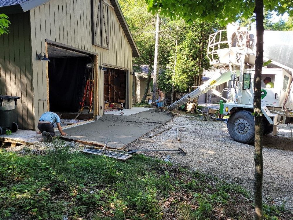

Back in February I was searching  for advice of how I could reduce the Oliver overall outside height because my extra building garage door height was approximately (and only)  3 inches too small. Potential solution advice included raising the ceiling and/or door height, installing different but smaller AC, letting air out of the tires, taking the tires off and more. None of the ideas, while appreciated, just didn't appeal to me and/or would not work.

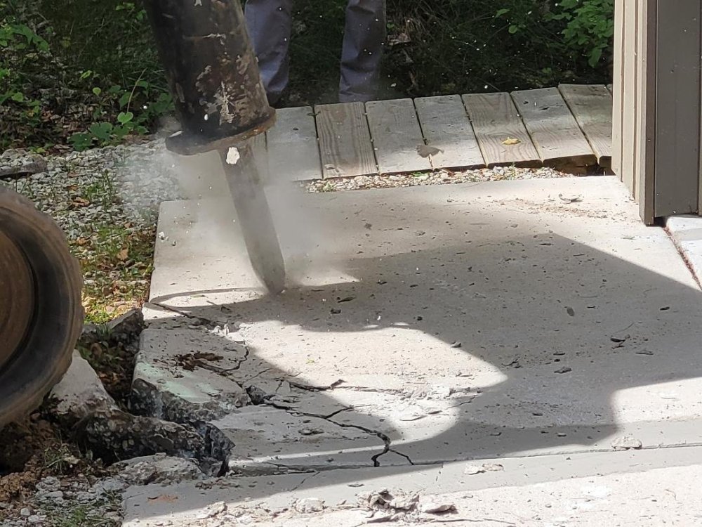

So...I am lowering the floor!
See the attached photos.

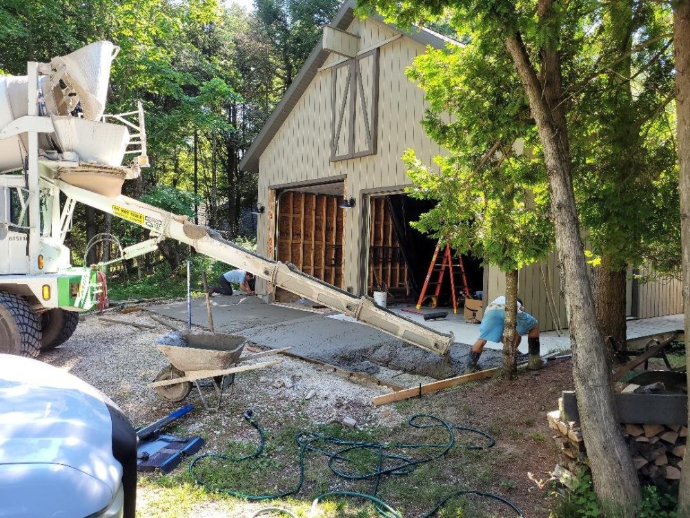

We install steel rod and pour concrete during the next couple weeks. Photos of (the successful?) the completed project to be shared in the future.

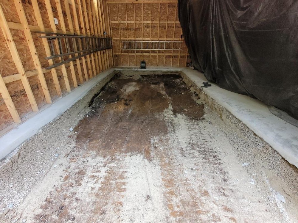

Cool! I assume you are going to add some in-ground drainage? How many inches lower will the new slab be?
John the project is now ovet excavated to allow for the placement of gravel before pouring the floor. There will an additional floor drain installed in the center of this bay in the new low point.
The new door will be a full 10 feet. The floor will slope in to a maximum new additional depth 1 foot down where the Oliver wheels are. This allows good clearance under the garage door opener.

How do you plan to deal with outside storm water? Will it have a natural surface escape route on the driveway? Do you have a plan to keep the slab catch basin and it’s drain pipe clear from dirt and organic debris? I have dealt with drains that are prone to blocking and it is best to design them to be very easy to maintain. Have you considered a trench drain? Otherwise you might hate it. Especially if you can’t access it without hitching up the Ollie and moving it out of the way.
NDS 864GMTL 5-Inch Pro Channel Drain Kit with Metal Grate, 5 in, Gray
Make sure the pipes have at least a 1/8” per foot slope or they won’t flow well.

I'll be interested in seeing your photos along the way. Is the contractor who built your garage doing the modifications? How are you underpinning that existing foundation under the load bearing wall? What will hold back the exposed soil? Has the crew shored up that "ledge" in case of rain?

SeaDawg. No the original contractor is not involved with this project. A couple of us are the main crew doing the work and we are bringing in contractors as we need equipment and/or a couple younger/strong backs.
Standard concrete project design and construction. The finish project will have vertical concrete walls pinned into the existing slab & the building footings. The vertical walls will also have angle rebar connecting to the floor slab rebar. No remaining exposed soil.

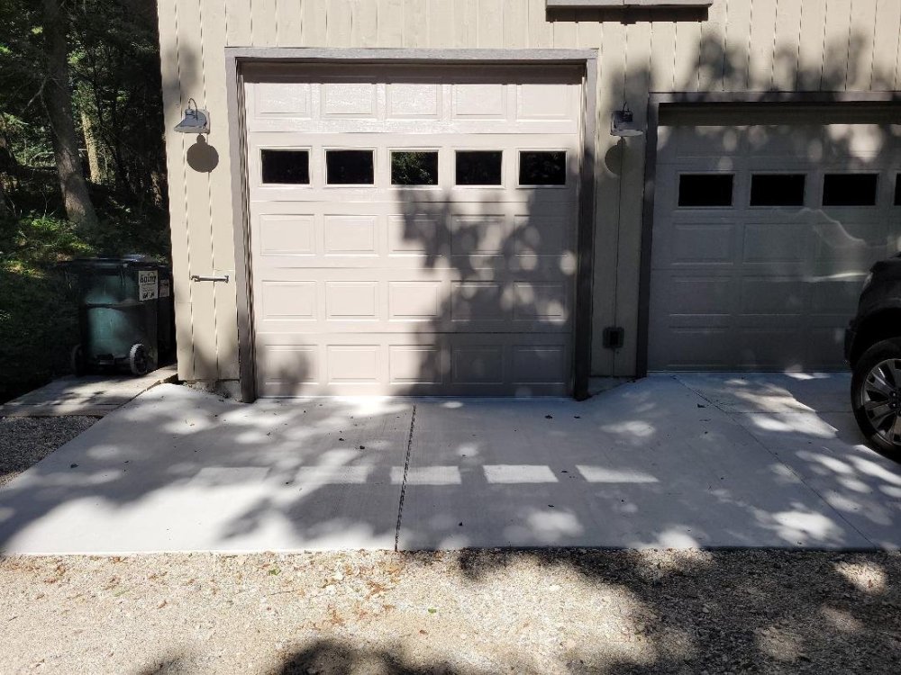

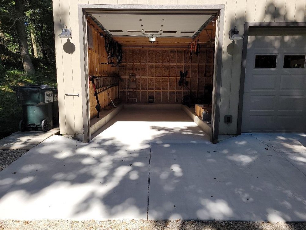

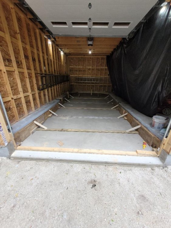

New concrete floor slab 12 inches lower.
Vertical walls poured.
New outside entrance concrete ramps poured & shaped.
A 10 ft entrance door installed.
All we need now is an Oliver Trailer.
