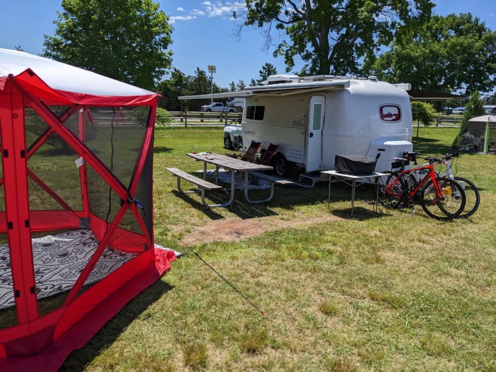

Nice pics!  I didn't realize that Clam made a "red" one - thought that green and brown were the only colors even though they do make ice shelters in a number of colors.

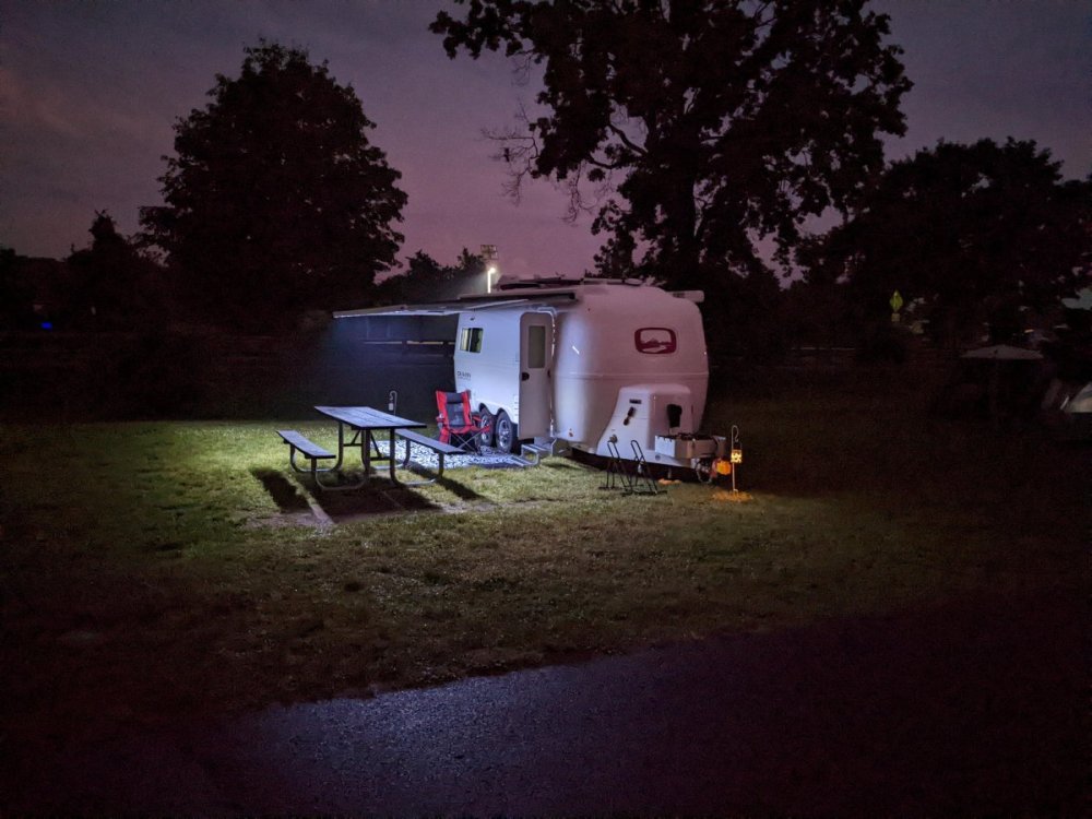

Your evening campsite photo is calendar worthy, imo. Looks so tranquil.
The red (or blue) one is the Escape Sport model. Their website isn't really clear on the differences between models, but the Sport has the rain flaps for the add-on panels and the upper screen windows zip completely open for better airflow on hot days. We like the white roof for hot days, too.
