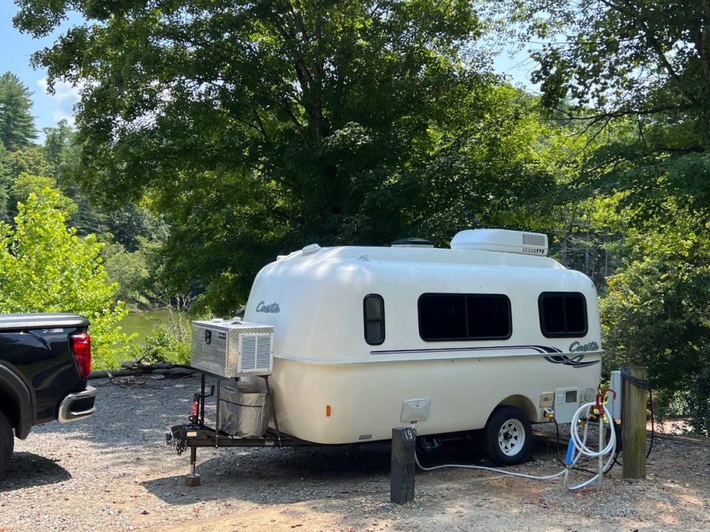

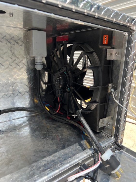

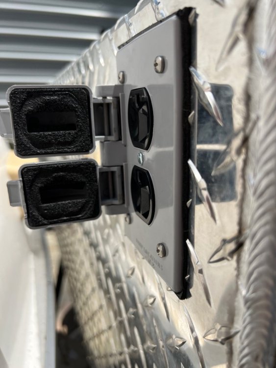

Joe and Janet Childers Posted April 7 Share Posted April 7 Joe built this "box" for our Casita which has been upgraded in our opinion to LEII #588. He will be glad to answer any questions if anyone is interested. I will take some pictures of it on the Oliver and post. No he is not interested in making the boxes to sell. I believe someone makes a nice box for Olivers. LEII 2020 Hull #588 Egg-Stream 2022 GMC Sierra 2500 Crew Cab Link to comment Share on other sites More sharing options...

Geronimo John Posted April 7 Share Posted April 7 (edited) On 4/7/2024 at 10:09 AM, Joe and Janet Childers said: oe built this "box" for our Casita which has been upgraded in our opinion to LEII #588. You and Joe did a nice job to create a secure yet light weight storage solution for your Honda. I really like the idea of open door, remove Honda gas cap, and fill through the top plate fueling port. Also the fan and electrical options that are included such as hard wiring a plug to the trailer panel for distribution, as well as having a single phase plug so that another trailer could plug into your single phase 30 amp plug and share some power. I am curious as to why it was mounted on 4X4"s/ It appears to encroach just a bit on the Bulldog, but not that much. The only option I can think of is to add a bolder catcher filter on the air intake side. With your set up, I bet you don't even know when the generator is running. Really nice set-up. Edited April 11 by Geronimo John TV: 2019 F-150 SuperCrew Lariat, 3.5L EcoBoost, Max Tow, FX-4, Rear Locker OLLIE: 2018 OE2 Hull 342, Twin Bed. OLLIE DIY’s: Timken Bearings, BB LiFePO4's, Victron 712 Smart, 350 Amp Master Switch, Houghton 3400, Victron Orion DC - DC, 3000-Watt Renogy Inverter, P.D. 60-amp Converter, Frig Dual Exhaust Fans, Kitchen Drawer Straps. TV DIY’s: 2 5/16" Anderson System, Nitto recon’s, Firestone Rear Air Bags, Bilstein 5100’s, Mud Flaps & Weather Tech all, installed Ham Radio (WH6JPR). Link to comment Share on other sites More sharing options...
Joe and Janet Childers Posted April 7 Share Posted April 7 I will get him to explain the mounting and design. We have had the Oliver just over a month…he may be still doing modifications. I know we have the tray from Oliver but he wanted a secure box. He was a nuc reactor operator in the Navy then owned a custom millwork cabinet shop. All the time building and making modifying projects. LEII 2020 Hull #588 Egg-Stream 2022 GMC Sierra 2500 Crew Cab Link to comment Share on other sites More sharing options...
