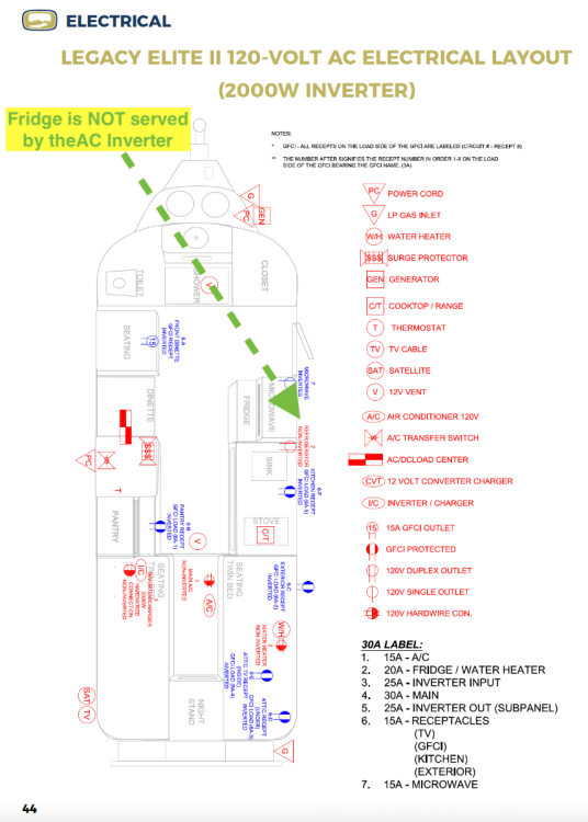

This may be obvious to more experienced owners, but I'll share here for other newbies like myself: the fridge outlet does not work on the inverter, so the AC only works when you're plugged into shore power. I thought, incorrectly, that if I turned the inverter on I could run the fridge on AC power. Learned something new, complete with the diagram from the manual (also sent by Craig Short)
that shows the fridge is not on an inverted outlet.

This was also my very first problem to solve on our first camping trip after picking up our Ollie in 2020.  It was aggravating that I ended up having to call Oliver Service after more than an hour of fiddling around with the fridge.  Even more aggravating that Oliver told me that all is normal due to how things are electrically connected to the inverter.  Embarrassed that it was such a simple issue, it was the first time I realized and mentioned to Oliver that the electrical diagrams for my trailer were MISSING from my owners manual!  I was told then they were no longer being made available.  Many owners of 2020+ Ollies have asked for electrical diagrams and the answers given by Oliver always vary and never make much sense.
I love my Ollie and I think Oliver is an outstanding company all around, but I have already spent WAY too much time tracing wires and trying to figure out what is connected to what.  Another silly example is the time I wasted trying to figure out why my TV wasn't charging my batteries while driving.  Another call to Oliver resulted in a simple answer that it wasn't connected when you order the Lithium package.  I have several others and I'm sure I will have several more.  I've spent WAY too much time making tweaks to the 2019 electrical diagrams so I actually have a partial one.  I dread having any type of electrical issue that I can't fix and have to take to a specialist.  Guess what they are going to ask for first?

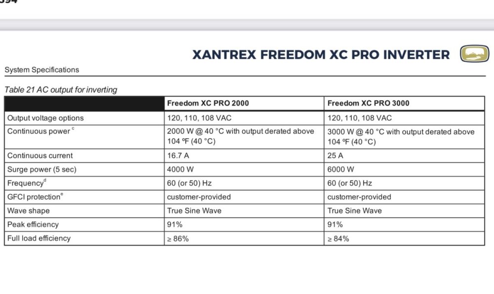

Unfortunately very few people really understand their equipment…. The specifications data is usually way at the end of the owners manual. If somebody was going to install it themselves, they would most likely see it shown on the product brochure.
PEAK efficiency is 91%. Full load (AKA running the air conditioner) is 86% or higher.
That wasted energy is discharged as heat by the inverter. It ends up under the bed and unless Oliver has changed their method, there is no way for that heat to be dissipated. In summer that means the inverter runs less efficiently because it requires adequate airflow for proper cooling.
It is really educational, and more than a little sobering, to watch the remote display of my Victron battery monitor, which shows the DC amps being used while inverting. My older 2000w unit draws close to 120 amps when operating the microwave. I refer to that appliance as the “Battery Killer” 😬, which irritates my wife because she loves it. But as the one who has to watch the battery condition (State of Charge) and drag out the generator if needed, it matters a lot more to me.
