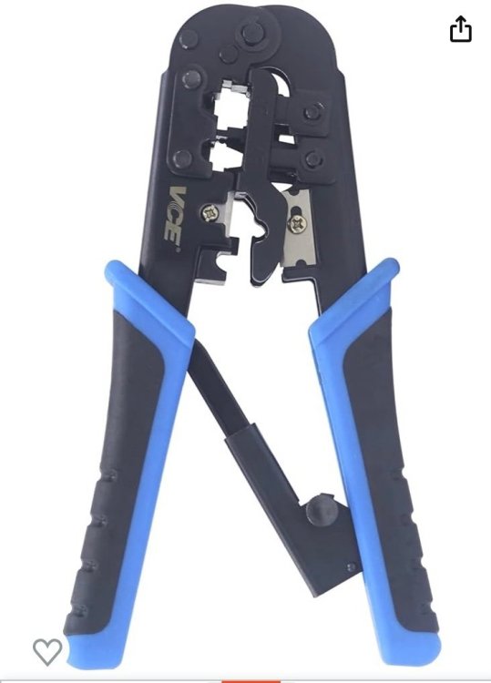

Heather and Eric Posted December 13, 2023 Posted December 13, 2023 Hi Everyone We purchased our trailer used a Month and a half ago and we noticed an E9 code on our Progressive EMS display in the attic cabinet. This was a “Data Link Down” message. Through troubleshooting we discovered it was a bad connection at the display end of the (phone cord looking-although it’s not really one) data cable. We purchased a pack of connectors and a crimp tool replaced the cable end with a new one. Also we unscrewed the cabinet wall that the display sits on and found probably 10-20 feet of cable coiled and stowed back there so we shortened the cable to clean things up. Things are working fine now. Understand this is a little random to the subject but we wanted to post it that maybe someone else might have a similar problem and could benefit from this easy fix. 1 3 Heather and Eric 2022 LE2 Standard hull #1147, tow vehicle Toyota Tundra Double Cab 5.7L Pacific Northwest
Moderators topgun2 Posted December 13, 2023 Moderators Posted December 13, 2023 35 minutes ago, Heather and Eric said: from this easy fix. Probably due to the environment that our trailer live in which includes heat, humidity, dust, dirt and vibration it is not too surprising that the relatively small fragile contacts and/or wires in these data cords go bad. I don't know what the total cost of the tool and the bag of connectors was versus just purchasing a new cable, but, either way your solution now gives us at least two way to skin this cat.🐱 Thanks! Bill 1 1 2023 Ford F150 Lariat 3.5EB FX4 Max Towing, Max Payload, 2016 Oliver Elite II - Hull #117 "Twist" Near Asheville, NC
Heather and Eric Posted December 13, 2023 Posted December 13, 2023 Stringing a new cable was the first thing we tried but we couldn’t find an easy path down inside the back wall of the camper. Quite possibly a rookie installation issue on our part but the tool and connectors ended up being just 20 bucks 😄 3 Heather and Eric 2022 LE2 Standard hull #1147, tow vehicle Toyota Tundra Double Cab 5.7L Pacific Northwest
